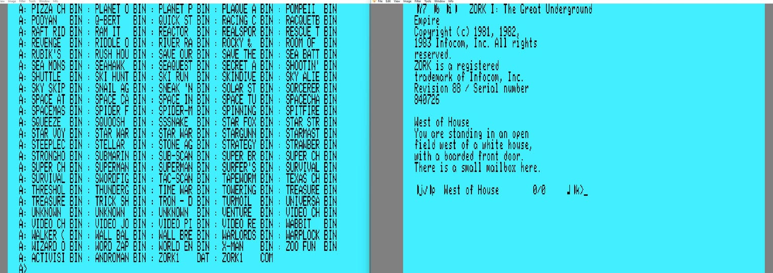

Nino also corrected a problem that was preventing proper "login" when switching between **CP/M 2.2 and CP/M 3 disk types**. The system can now handle both.
To put the large-disk support through a practical test, he configured a disk with a directory capable of handling **512 entries** and filled it with as many small Atari 2600 game files as possible. The Atari files weren't significant themselves—the idea was simply to create enough individual files to thoroughly exercise the enlarged directory.
He then deliberately placed **Zork I at the end of the 1440 disk**.
The result? CP/M 3 successfully reached Zork at the far end of the disk and ran it. It was a clever way of demonstrating that the expanded disk wasn't merely being recognized—the operating system could actually navigate the large directory and retrieve files stored throughout it.

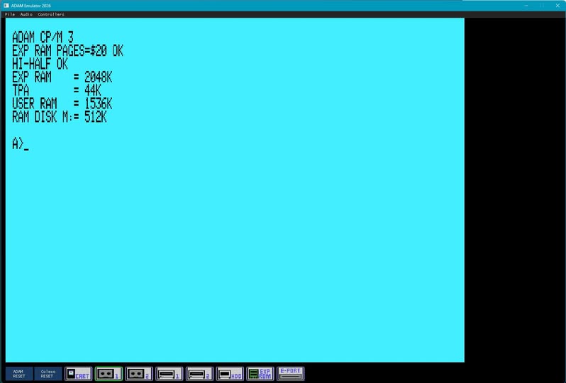

### Expanded Memory and RAM Disk
Another screenshot shows CP/M 3 recognizing a substantially expanded ADAM configuration:
**EXP RAM = 2048K**
**TPA = 44K**
**USER RAM = 1536K**
**RAM DISK M: = 512K**
So we're seeing CP/M 3 working with **2MB of expansion RAM**, with a portion being made available as a **512K M: RAM disk**.

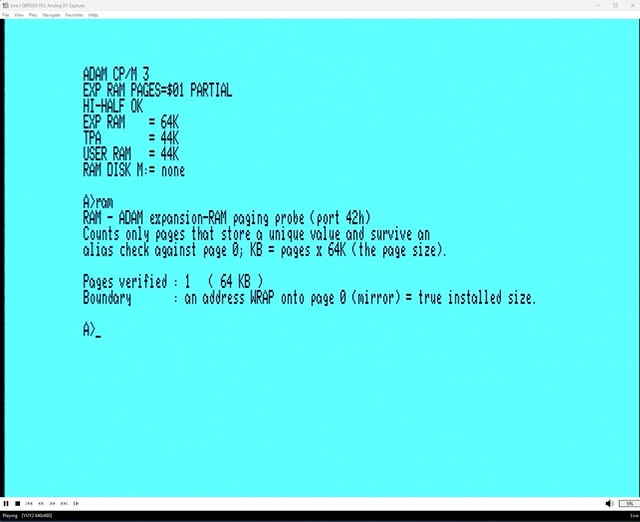

Nino has also developed a RAM-paging probe for determining how much expansion memory is actually installed. In another test configuration, it correctly identifies a **64K expansion**, including detecting the point at which the address space wraps back around rather than mistakenly counting mirrored memory as additional RAM.
That becomes important when software needs to determine the actual memory configuration rather than simply assuming a particular expansion is installed.

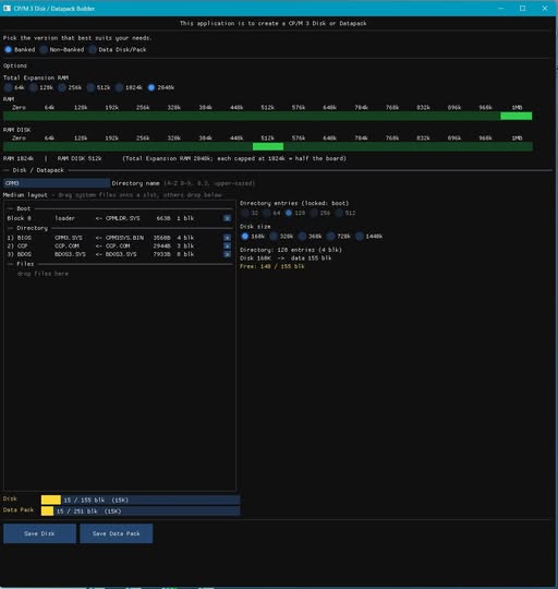

### Building CP/M 3 Disks and Data Packs
Another piece of the project is a **CP/M 3 Disk / Datapack Builder**.
The utility shown allows different ADAM configurations to be selected, including the amount of expansion RAM and RAM-disk allocation. It also provides control over the CP/M directory layout and disk size.
That should make creating properly configured CP/M 3 boot media considerably easier than manually assembling everything for a particular ADAM hardware configuration.
