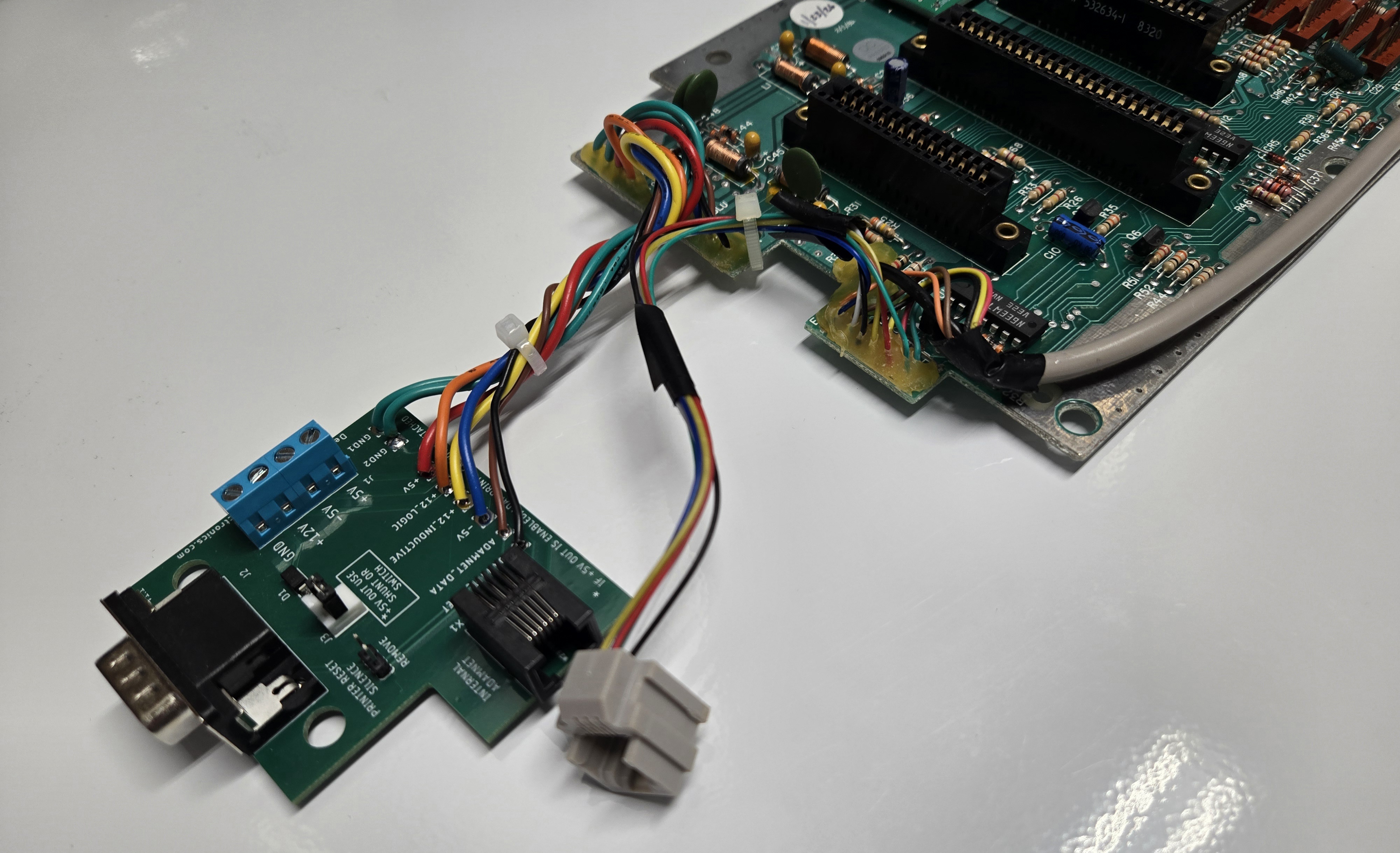

ADAMnet Power Inlet Board for Internal Power Supply Adapter
- Provides an Internal ADAMnet connector for internal expansions
- Provides an ADAMnet reset silence jumper for the ability to stop annoying printer reset
- Configure +5 out to DB-9 for use with Roller Controller power adapter or Coleco printer use only
https://lundyelectronics.com/product/co ... er-supply/

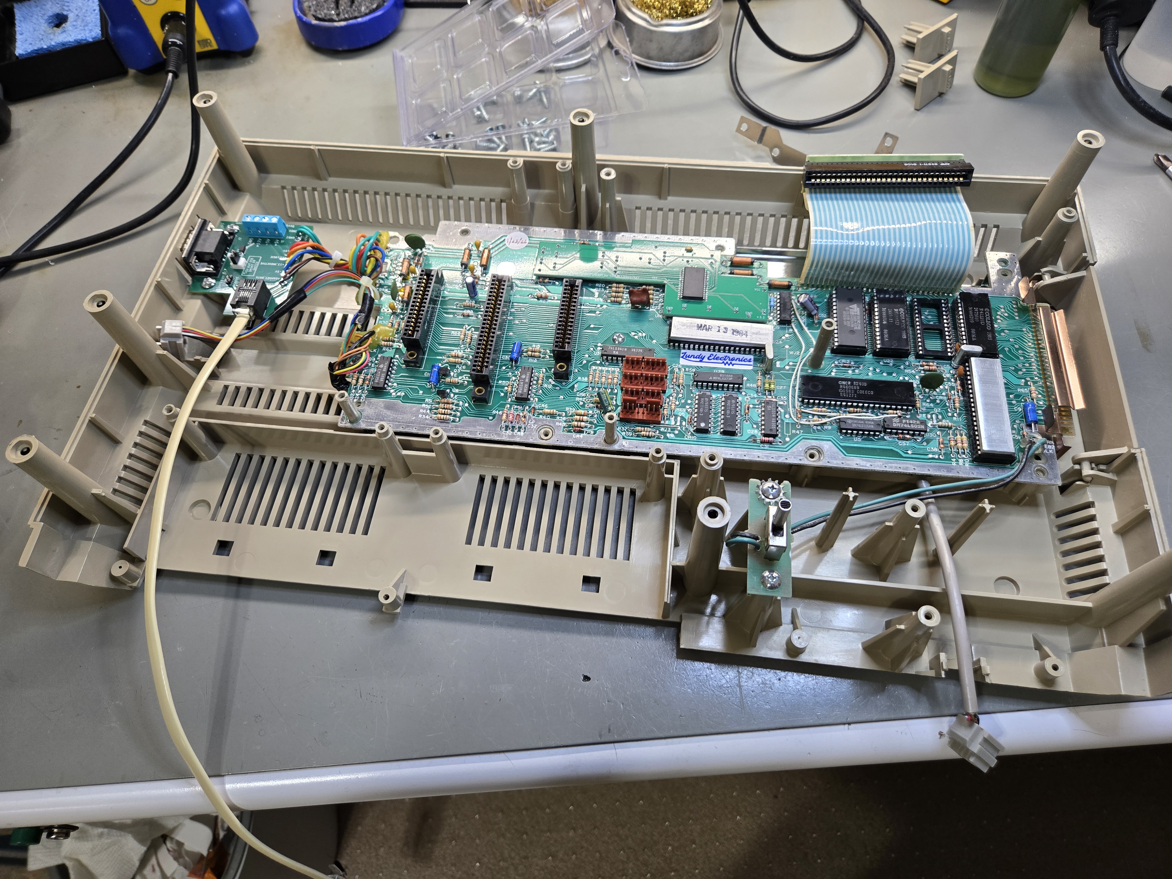

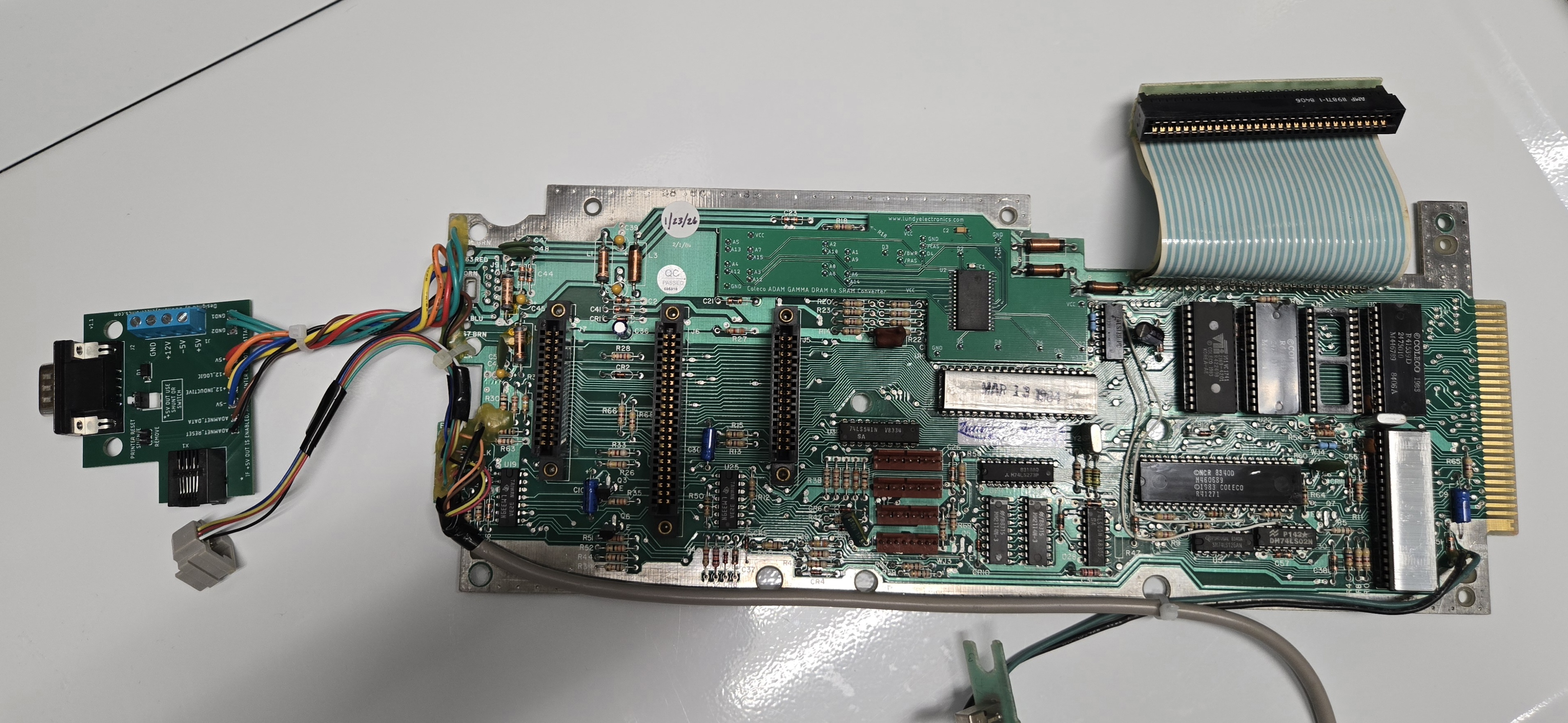

Re: Lundy Electronics SuperADAM 2026-1 build log

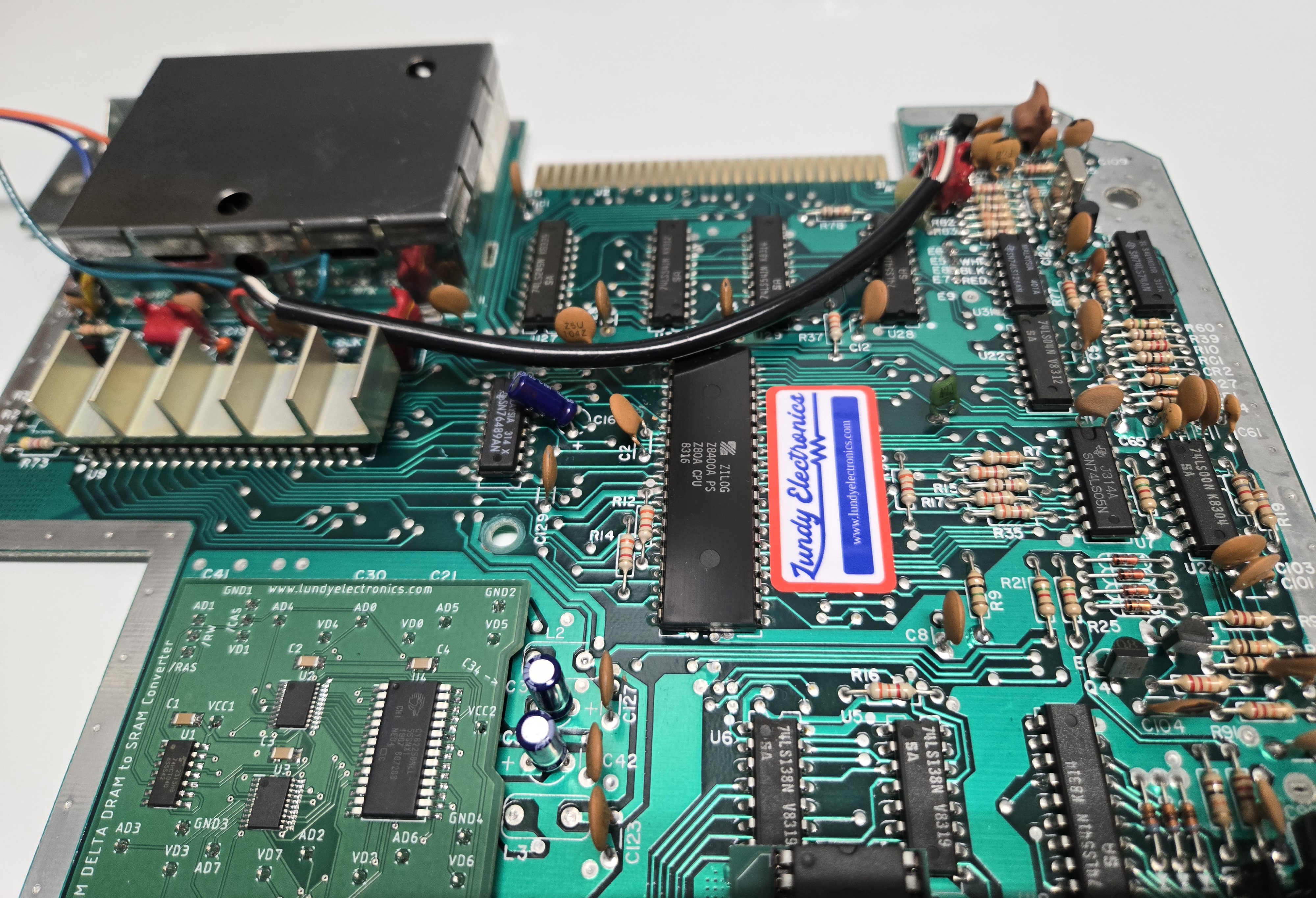

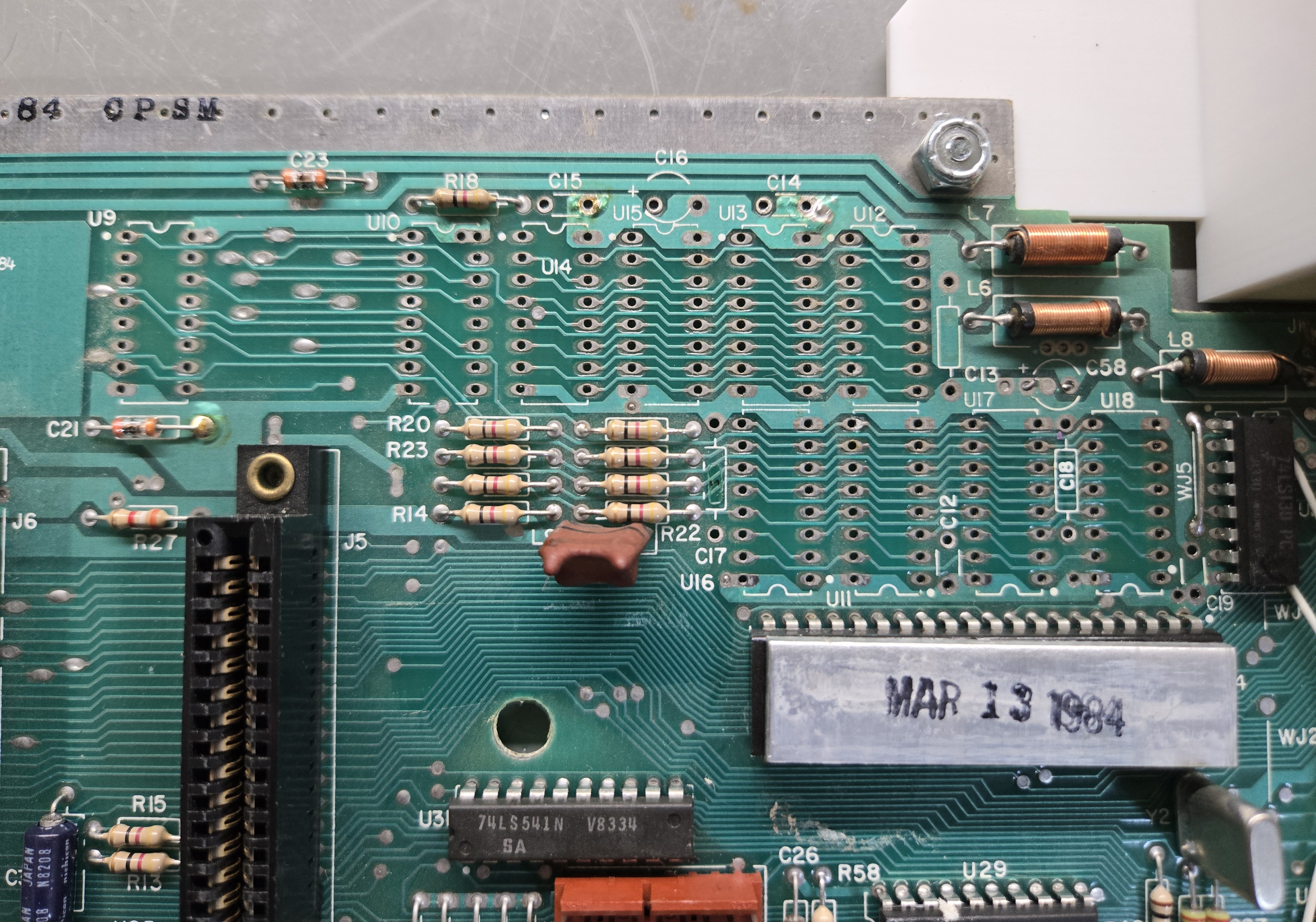

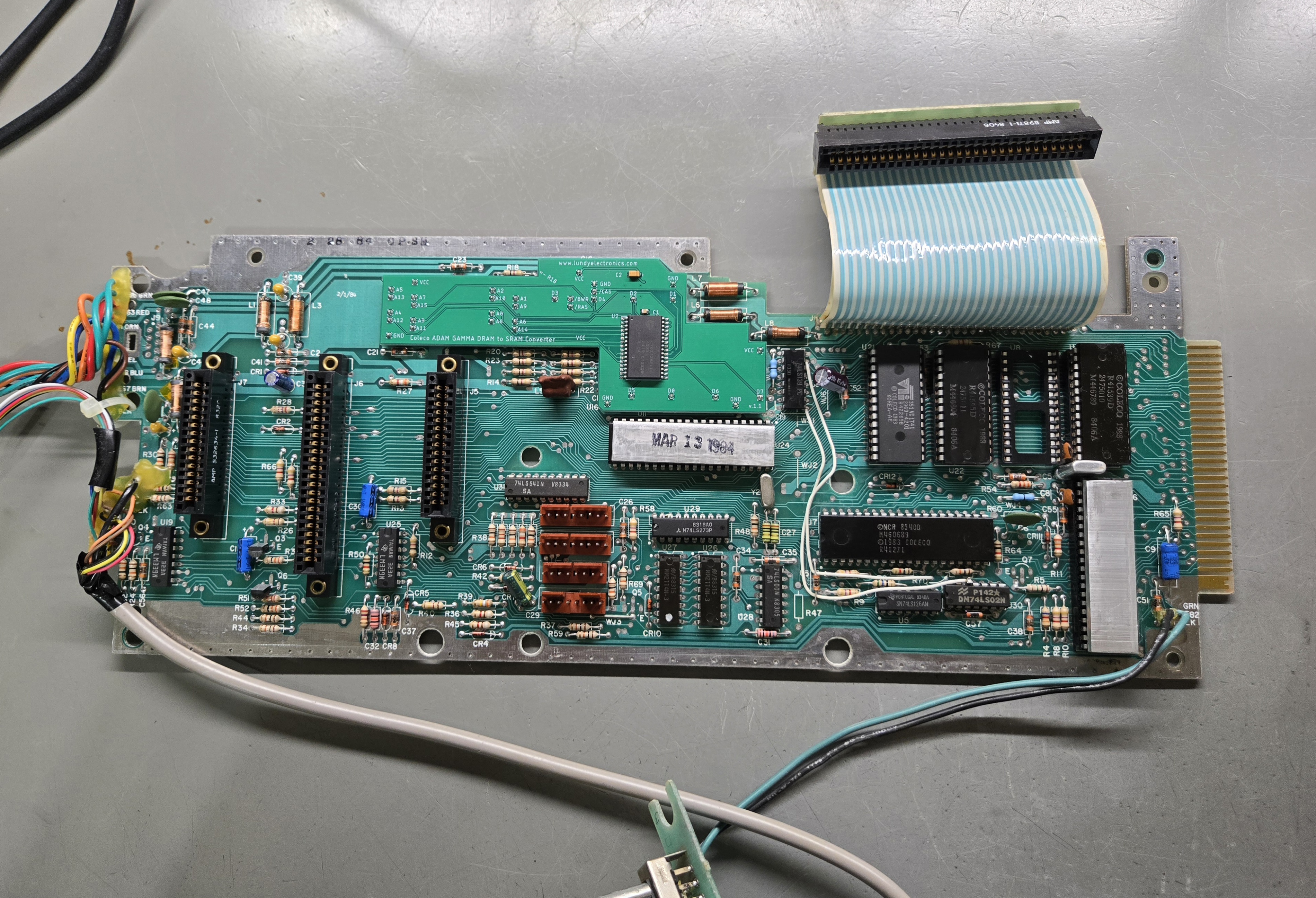

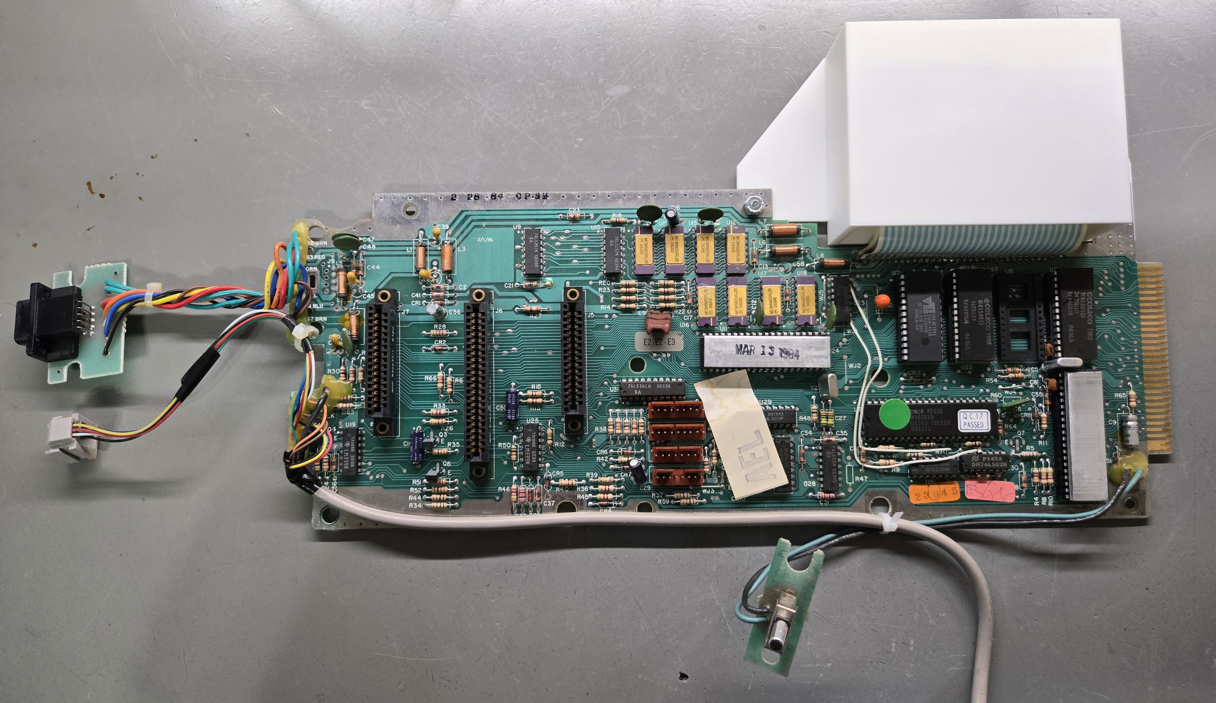

Post by Tekman »

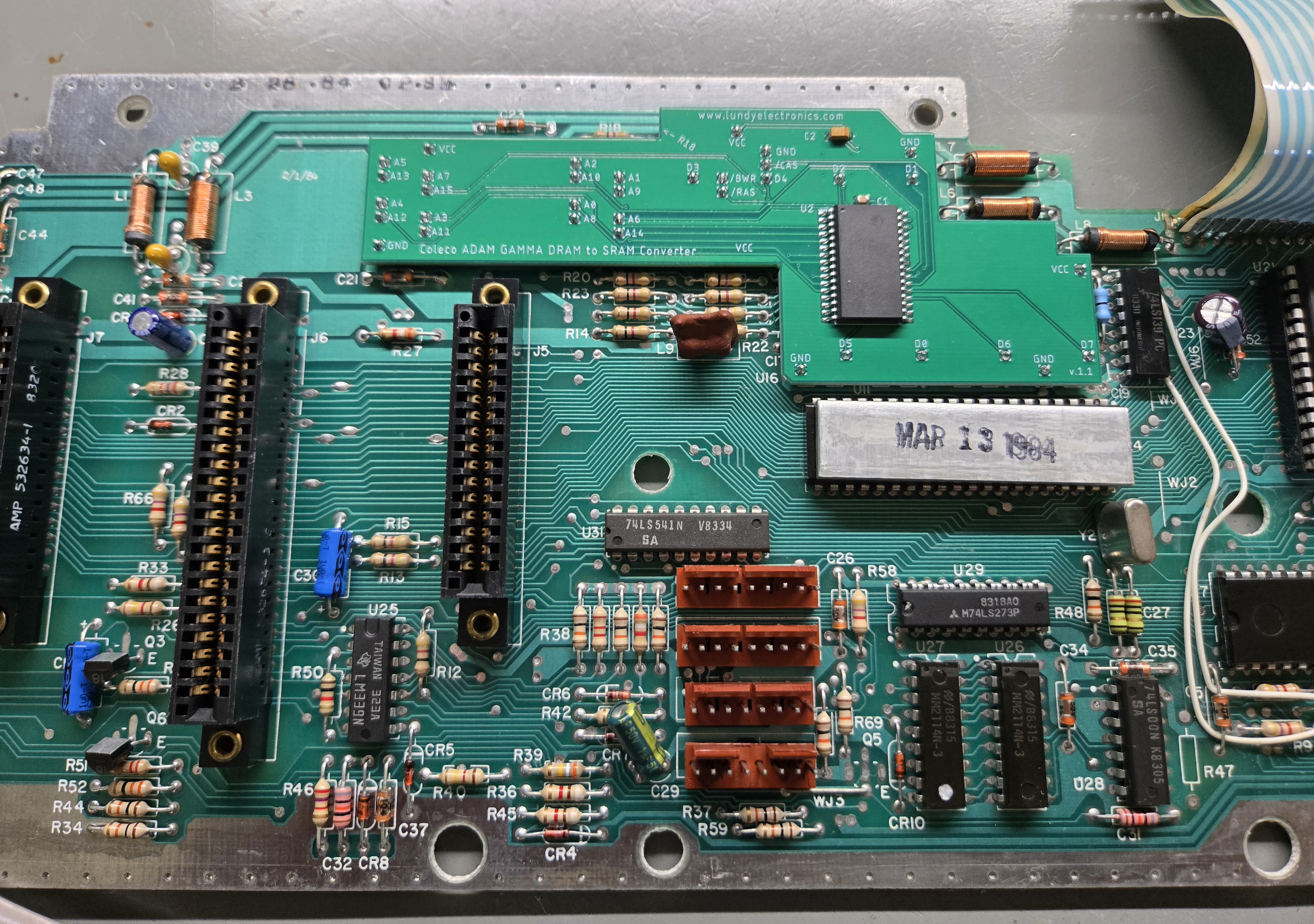

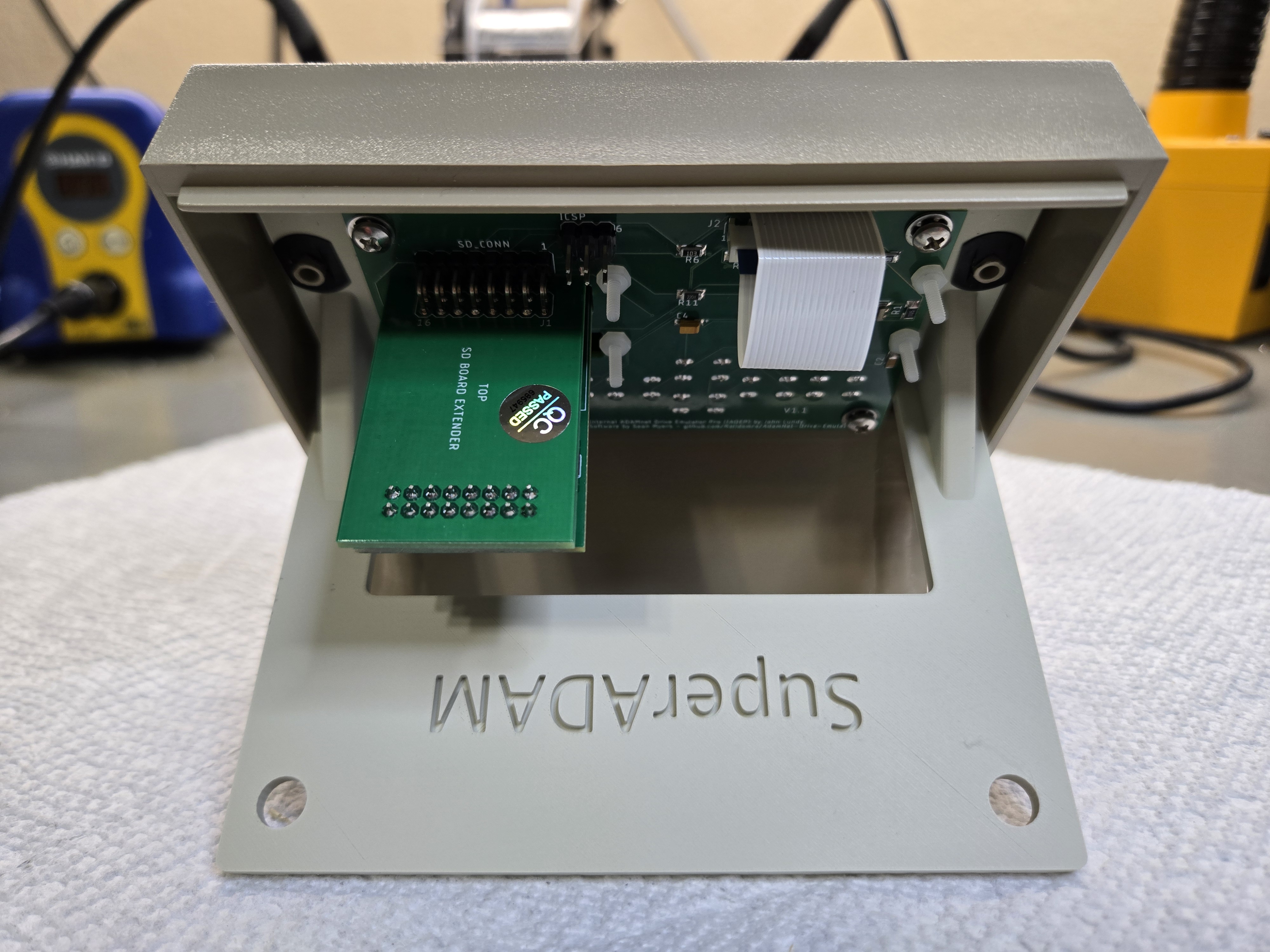

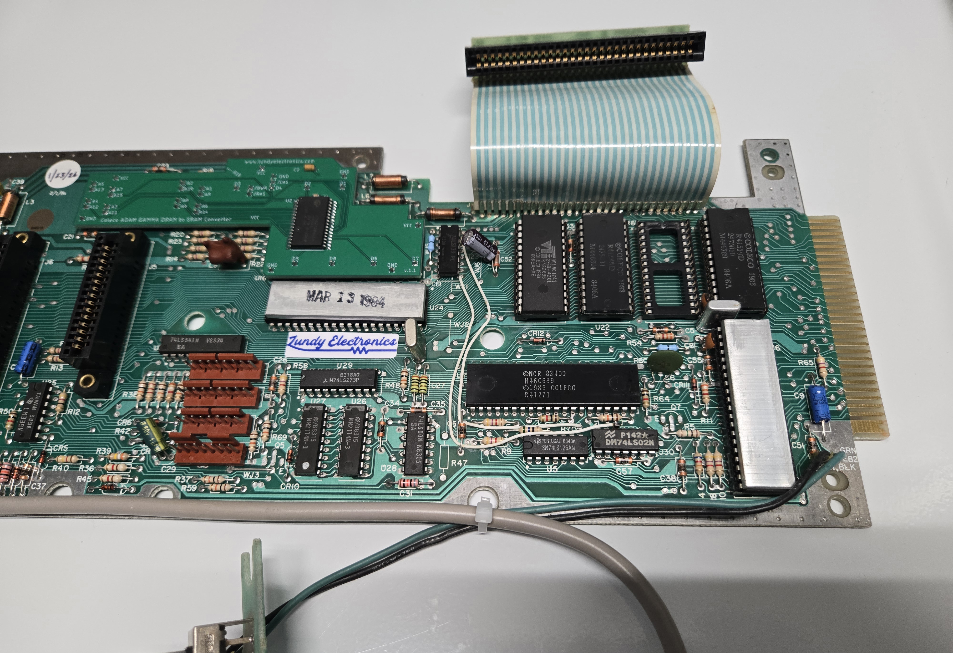

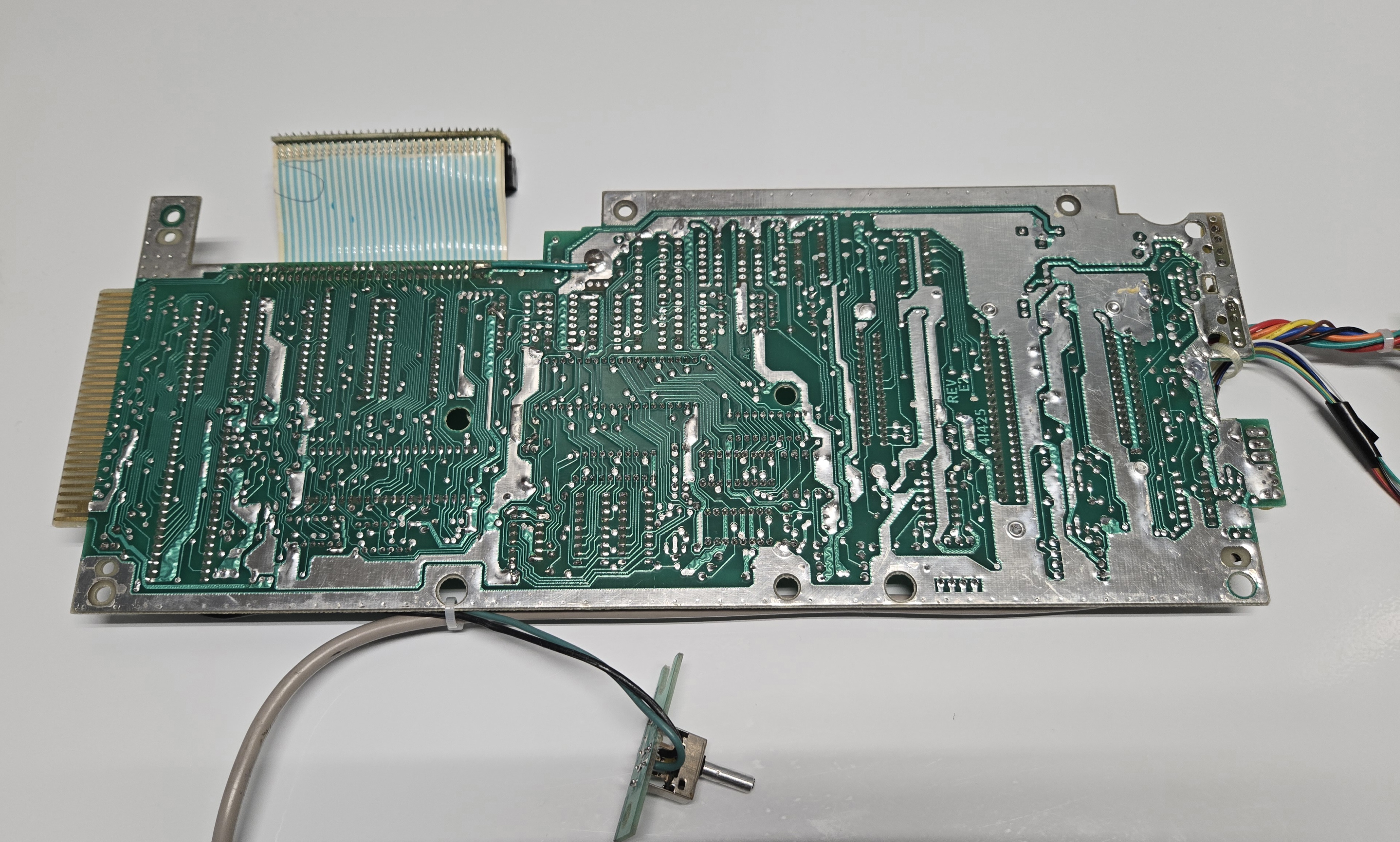

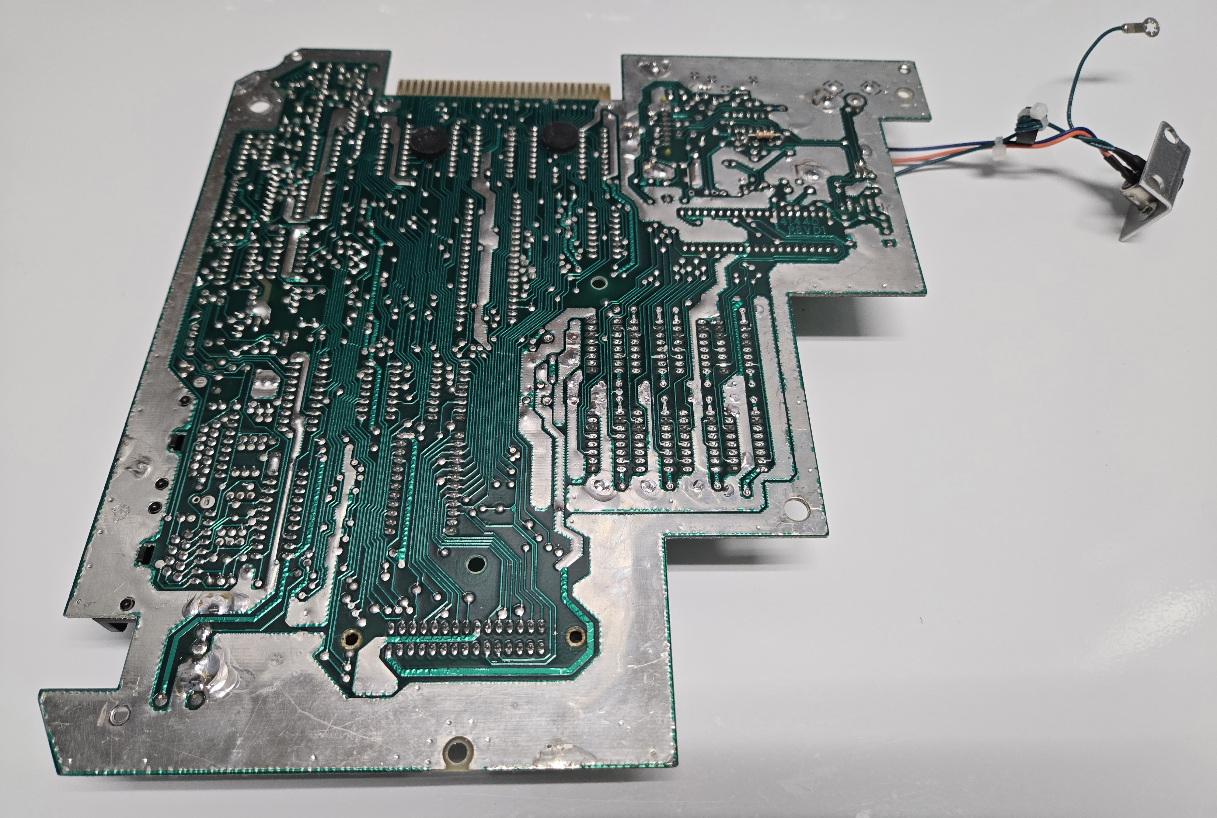

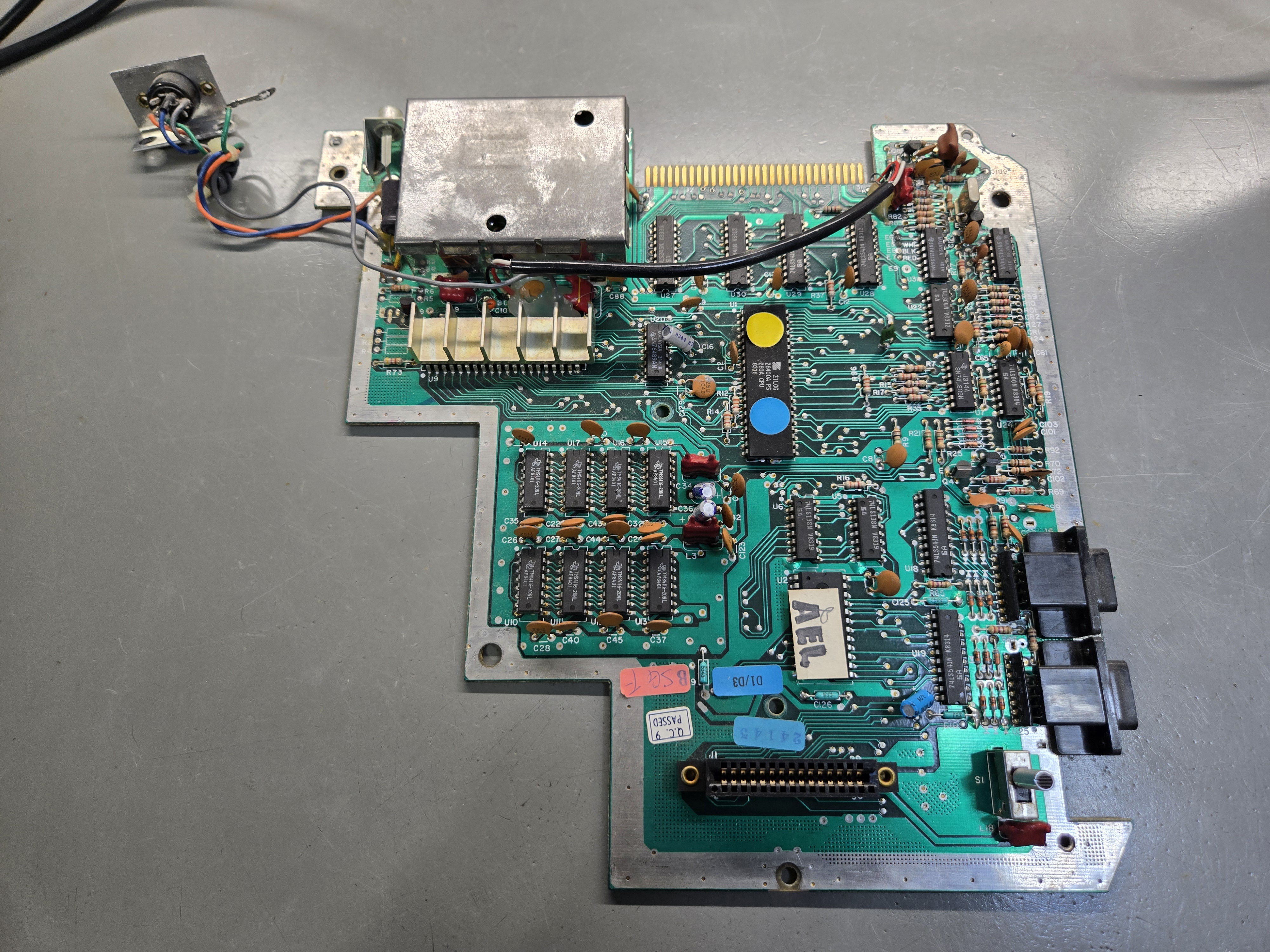

Reworking the PCBs first

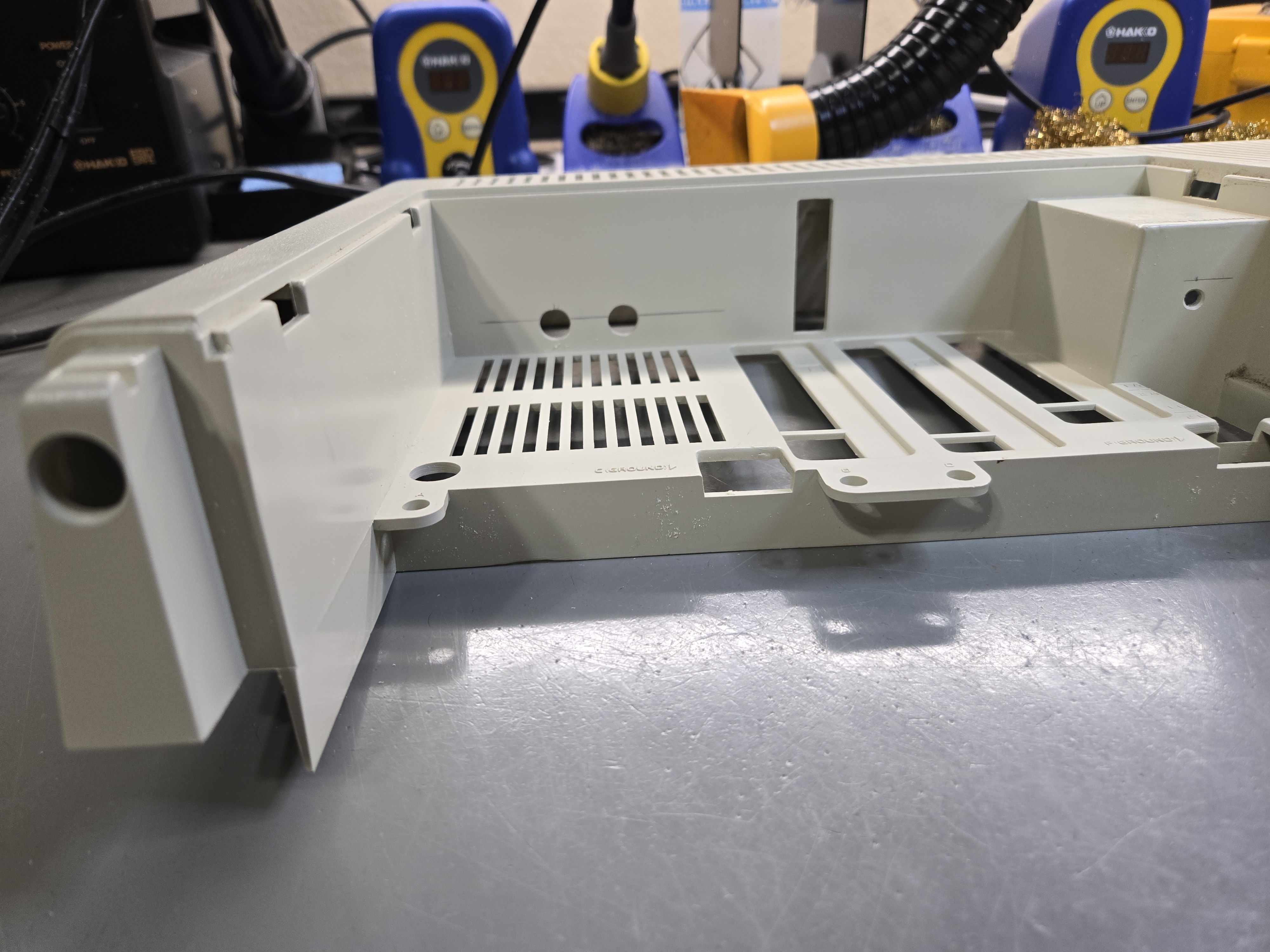

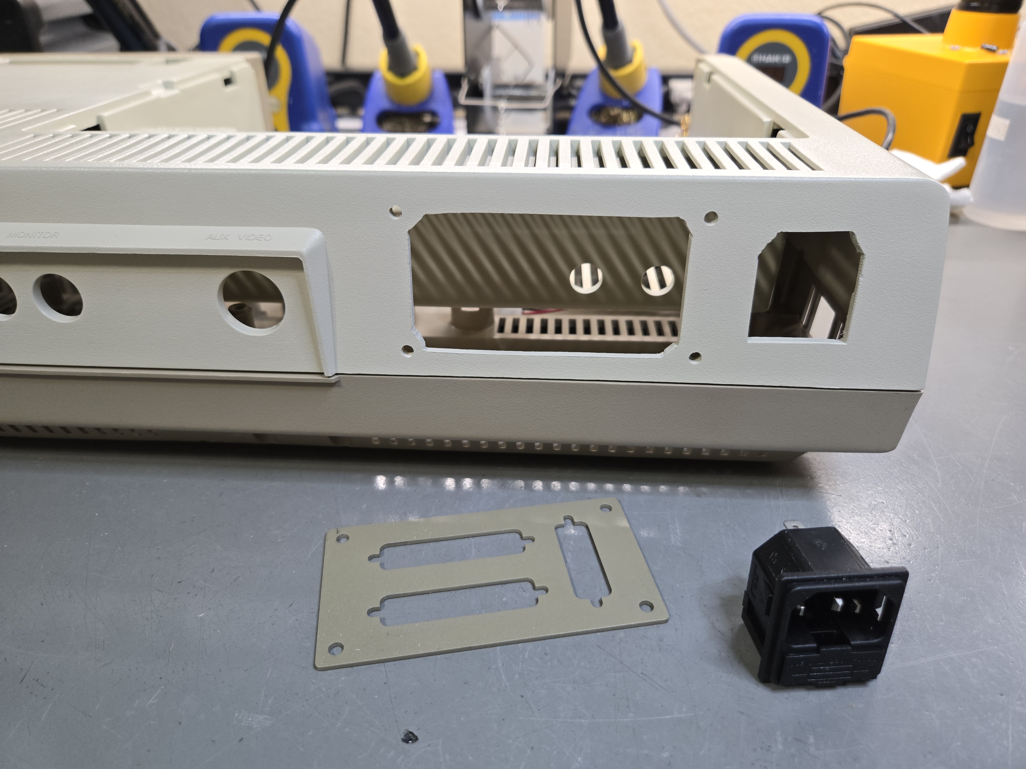

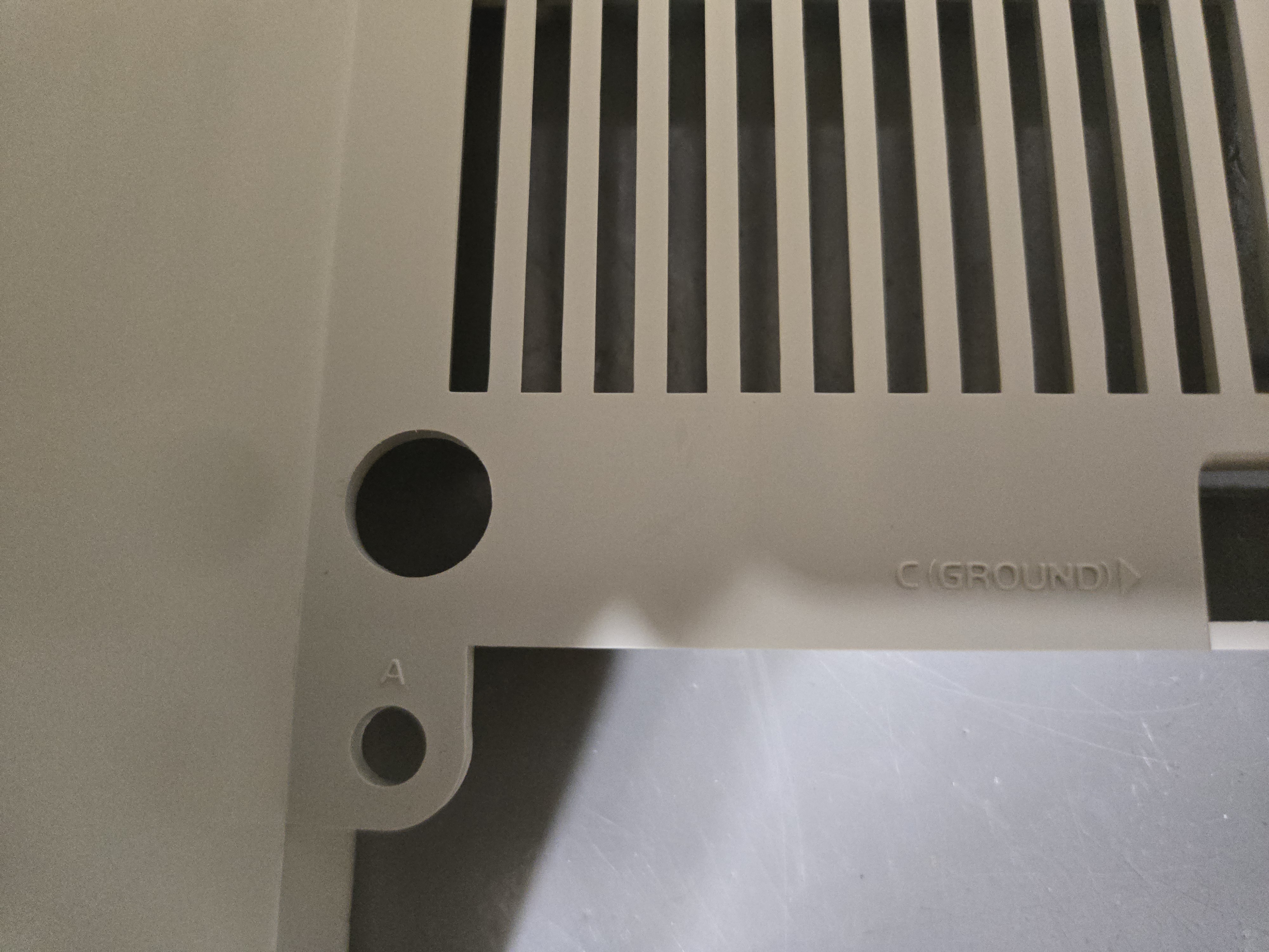

Post by Tekman »

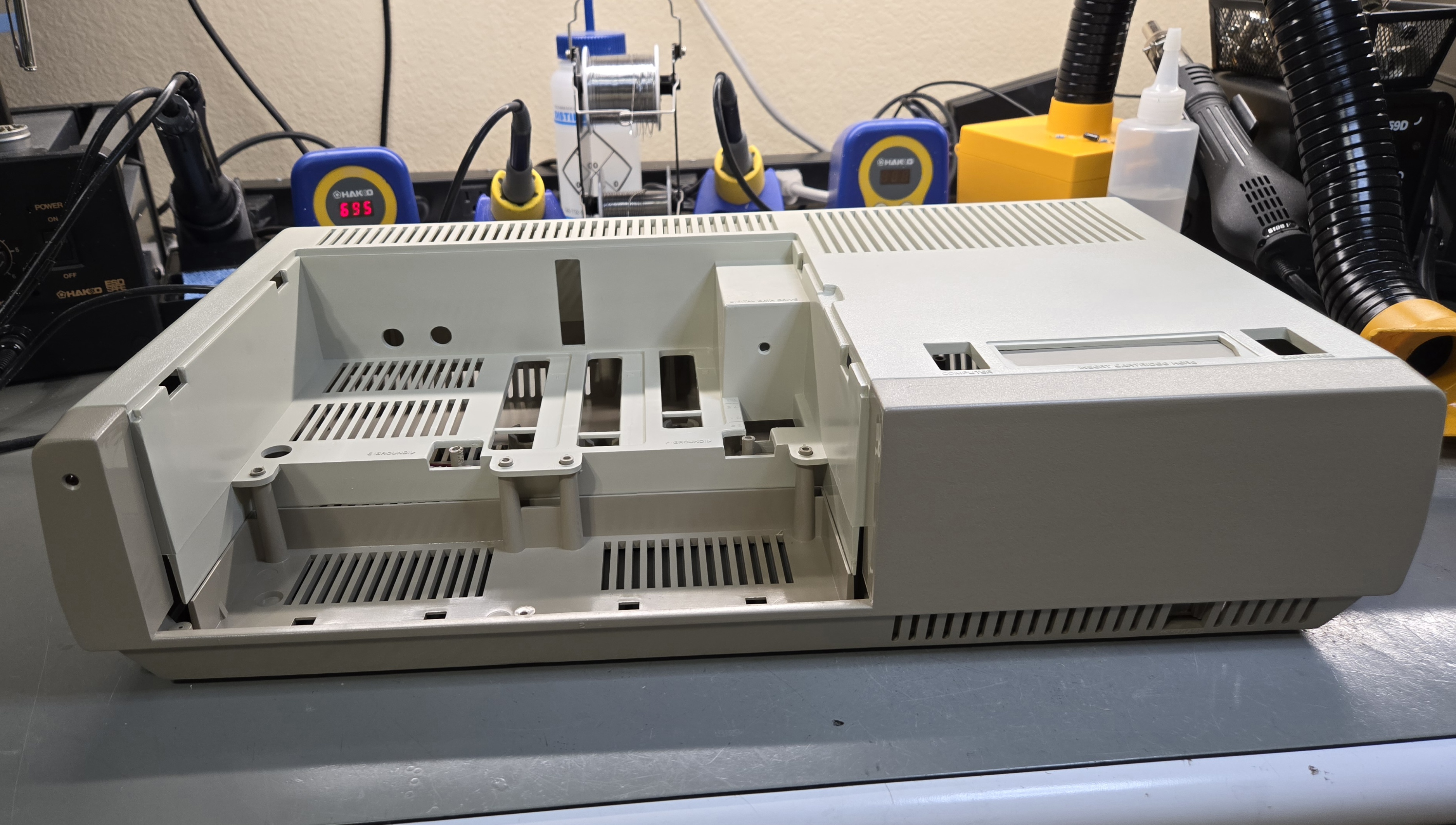

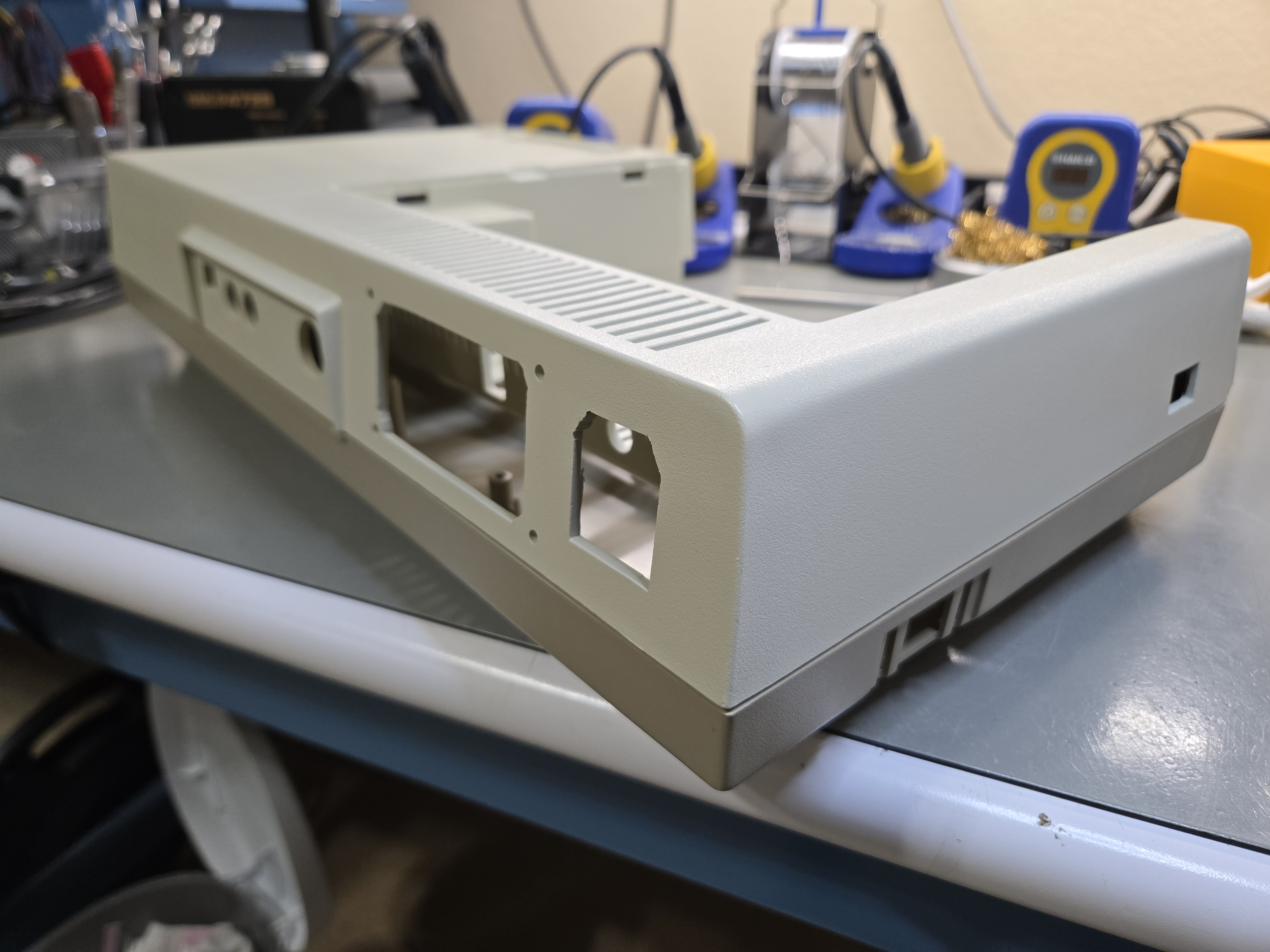

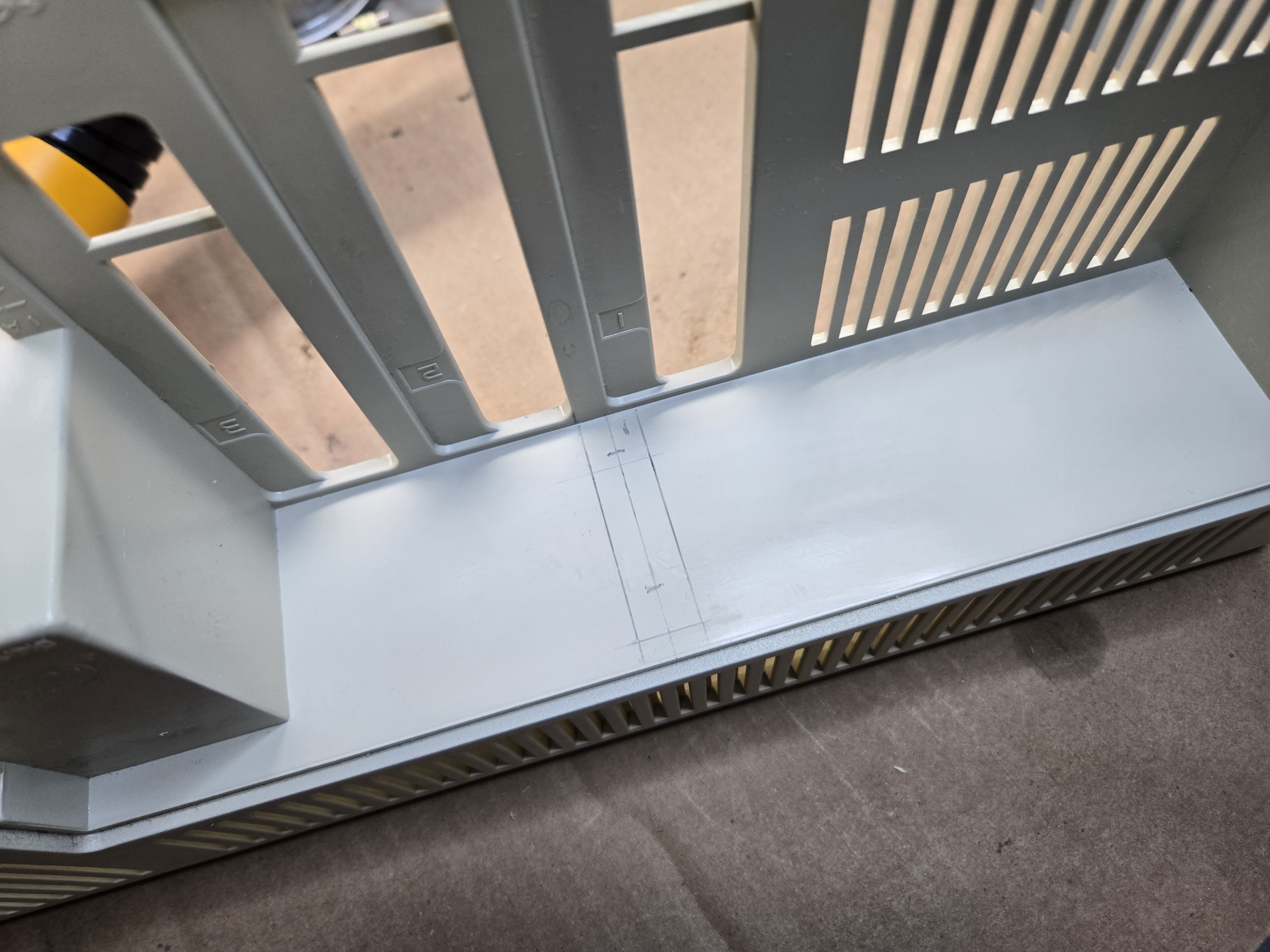

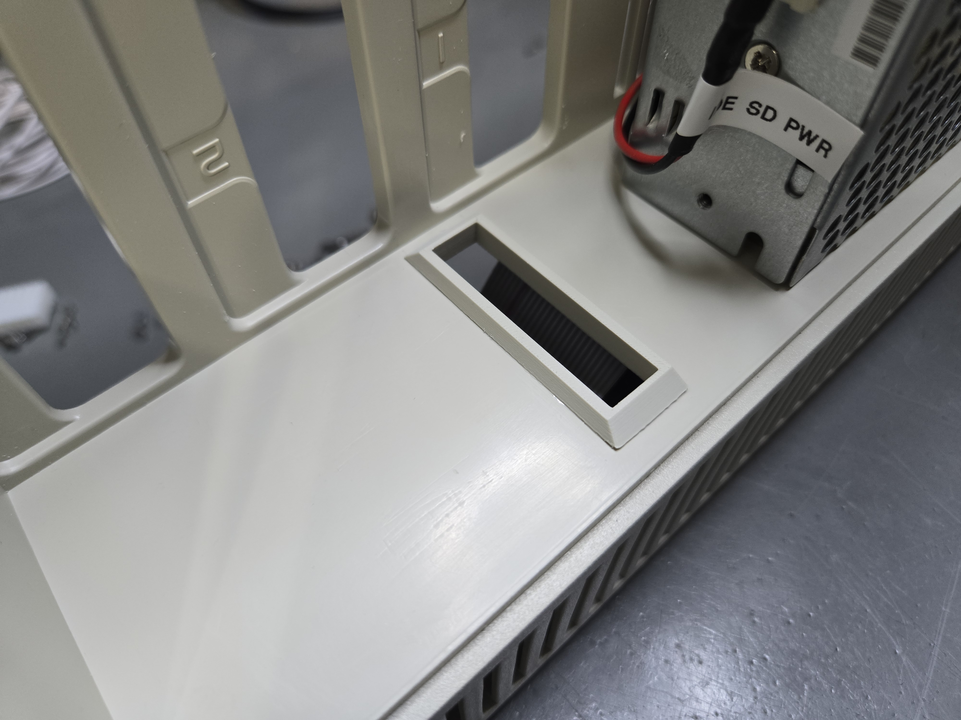

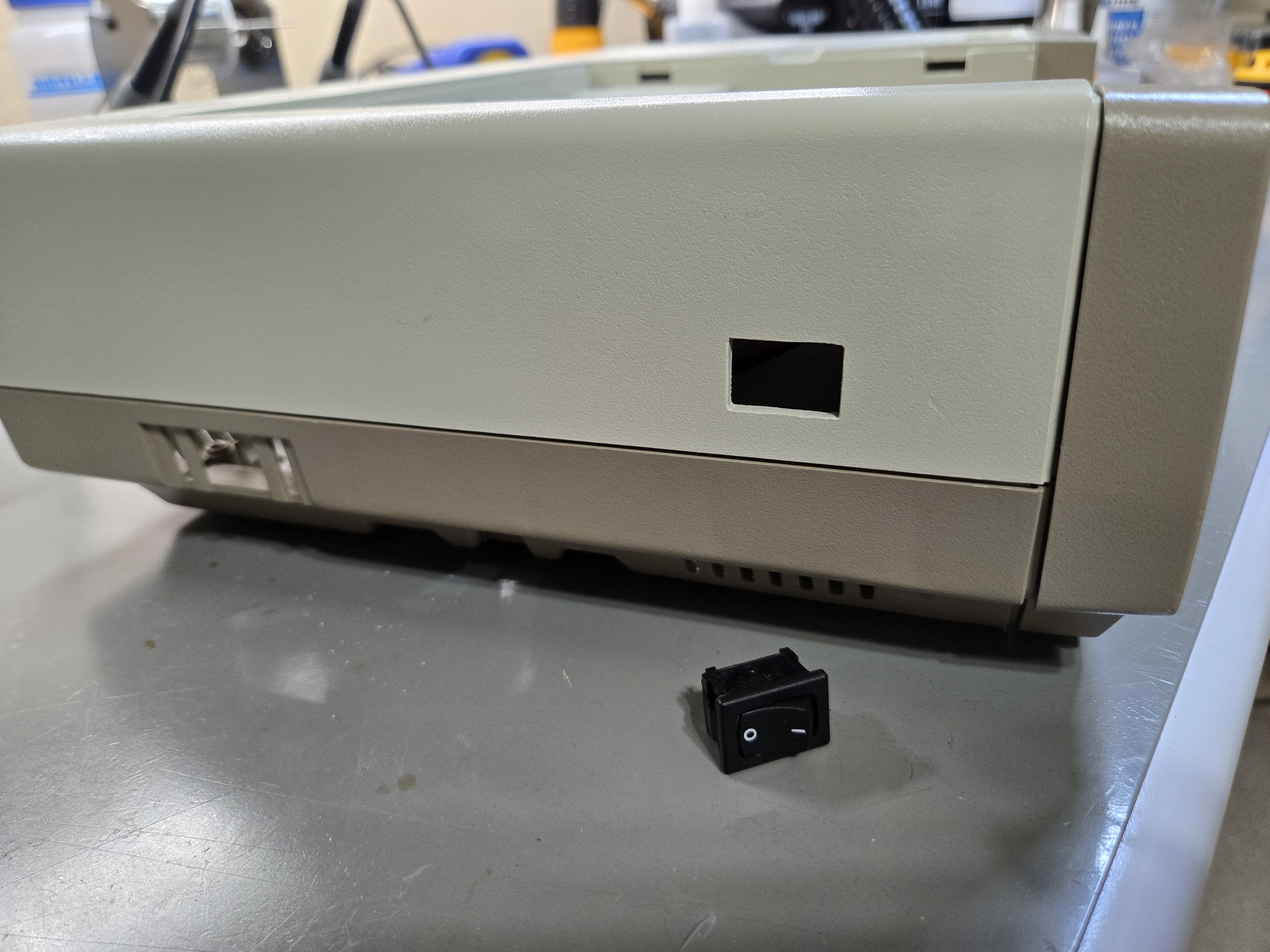

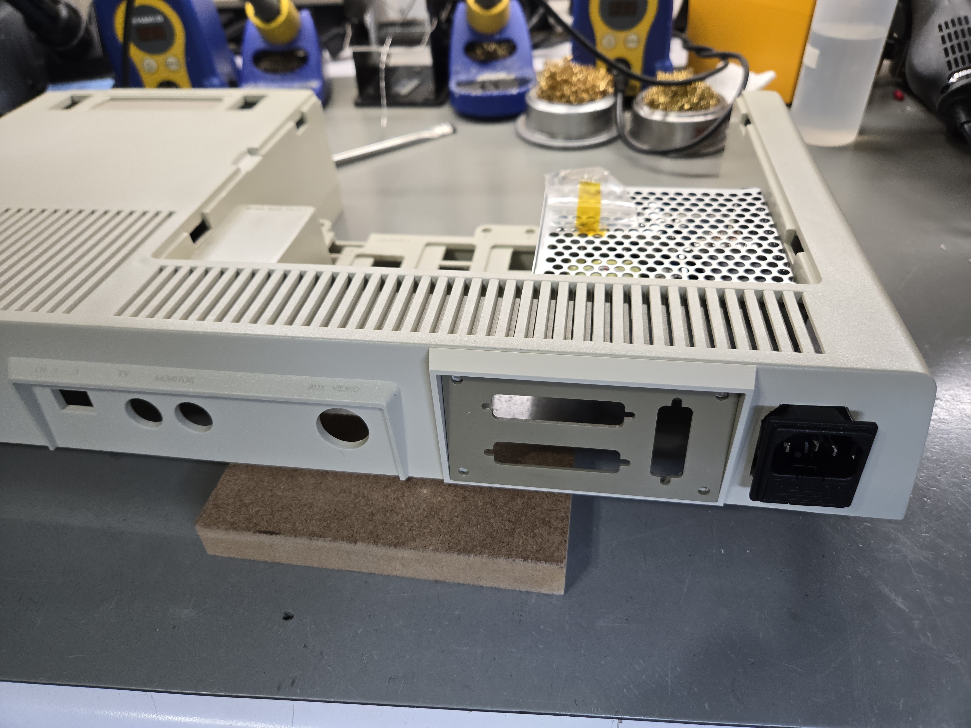

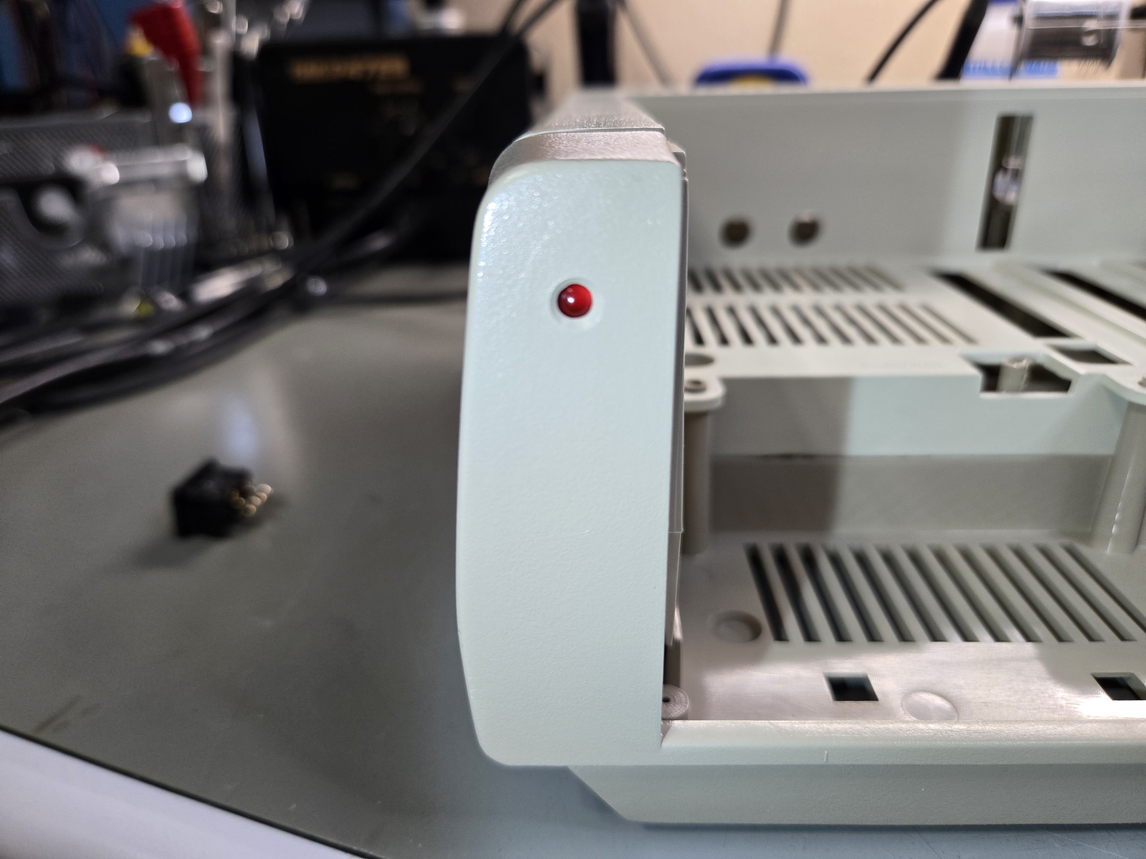

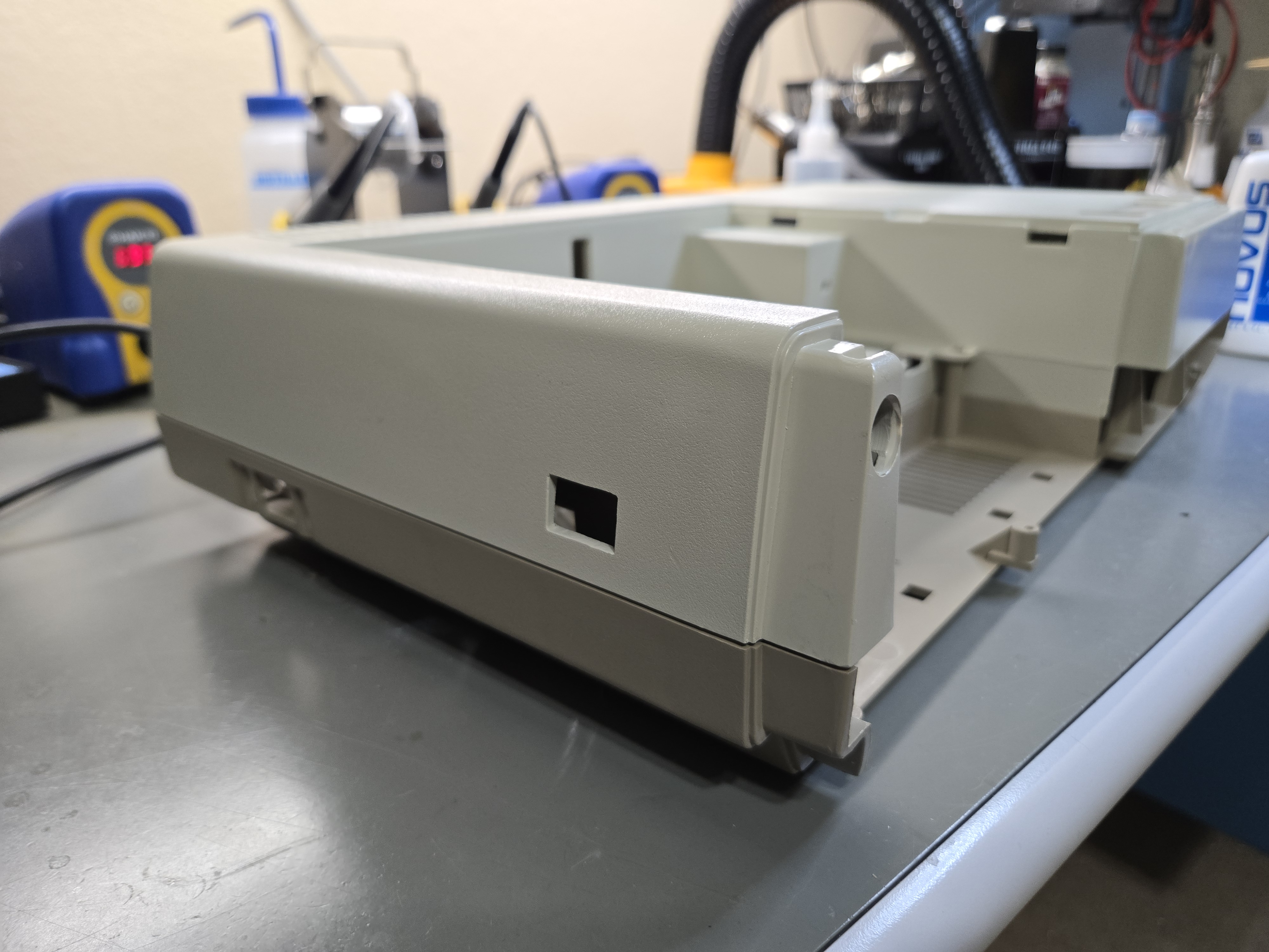

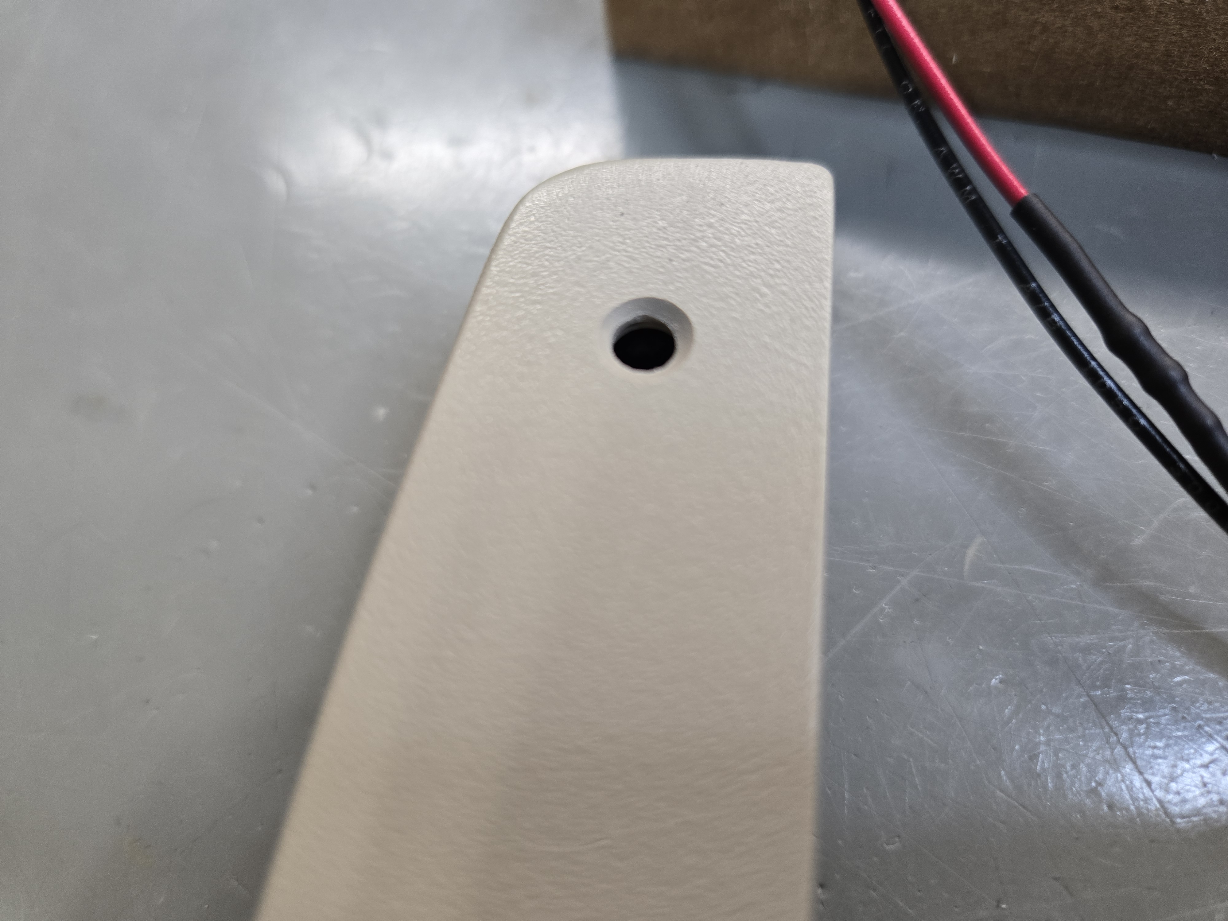

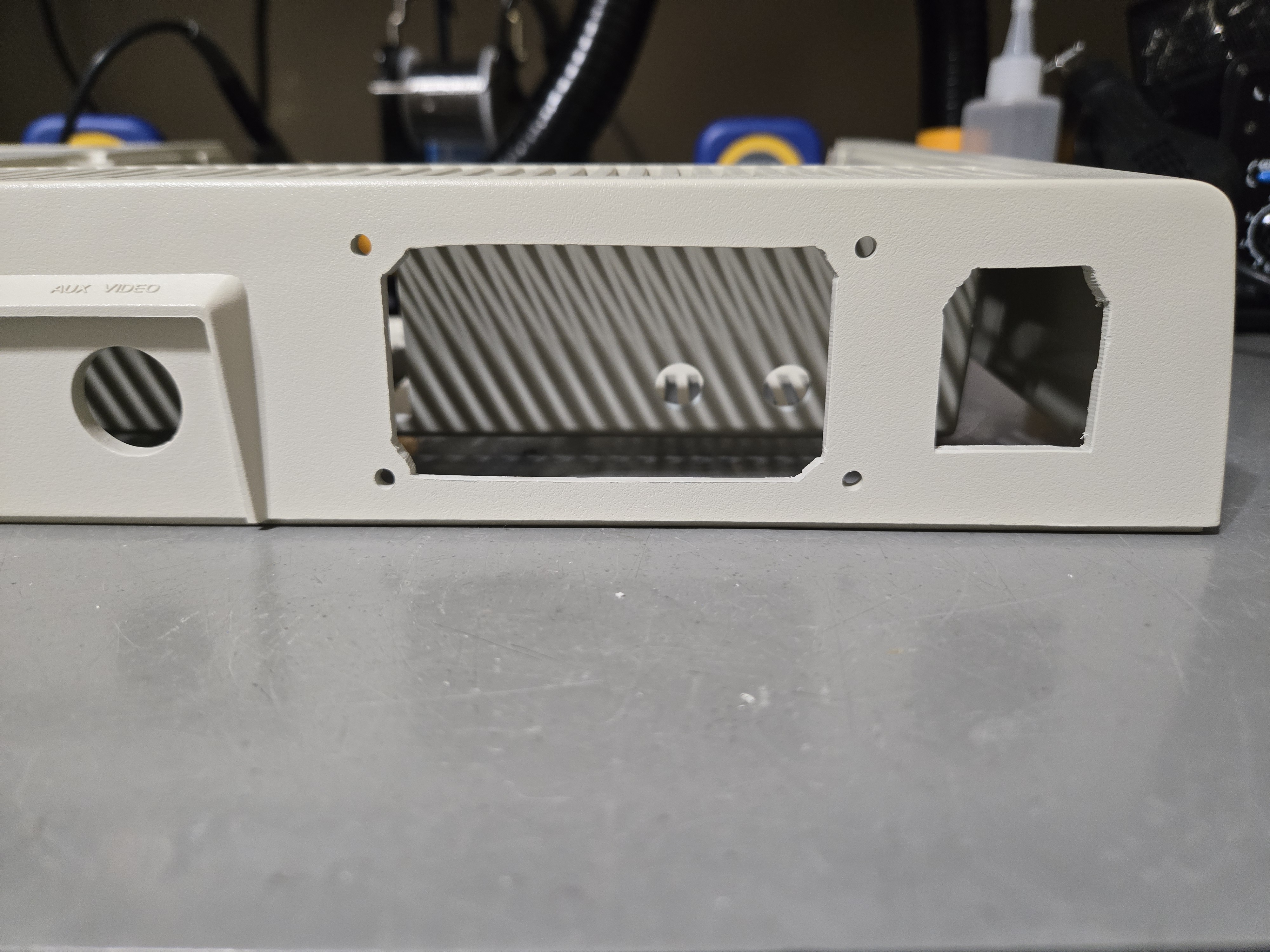

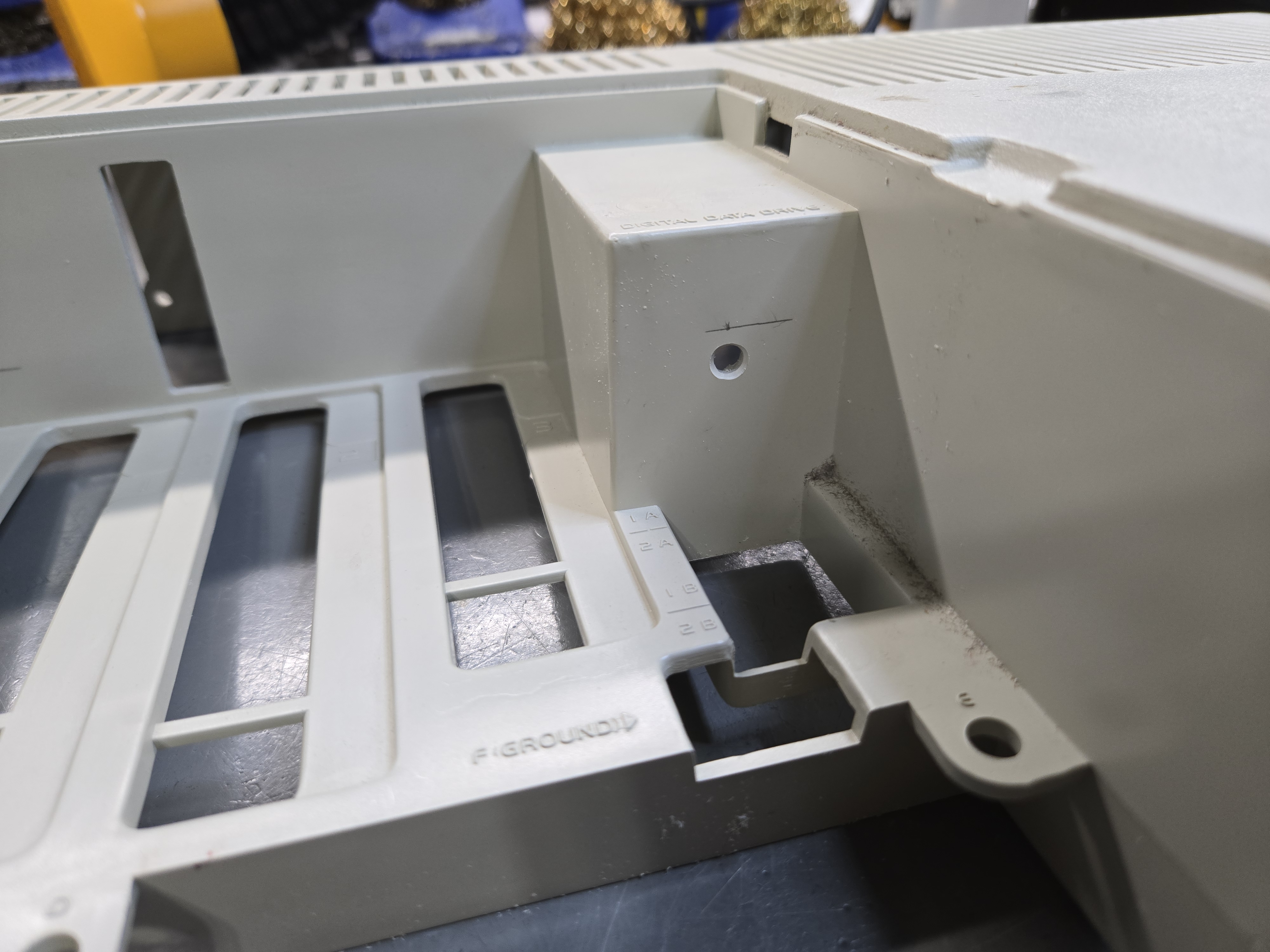

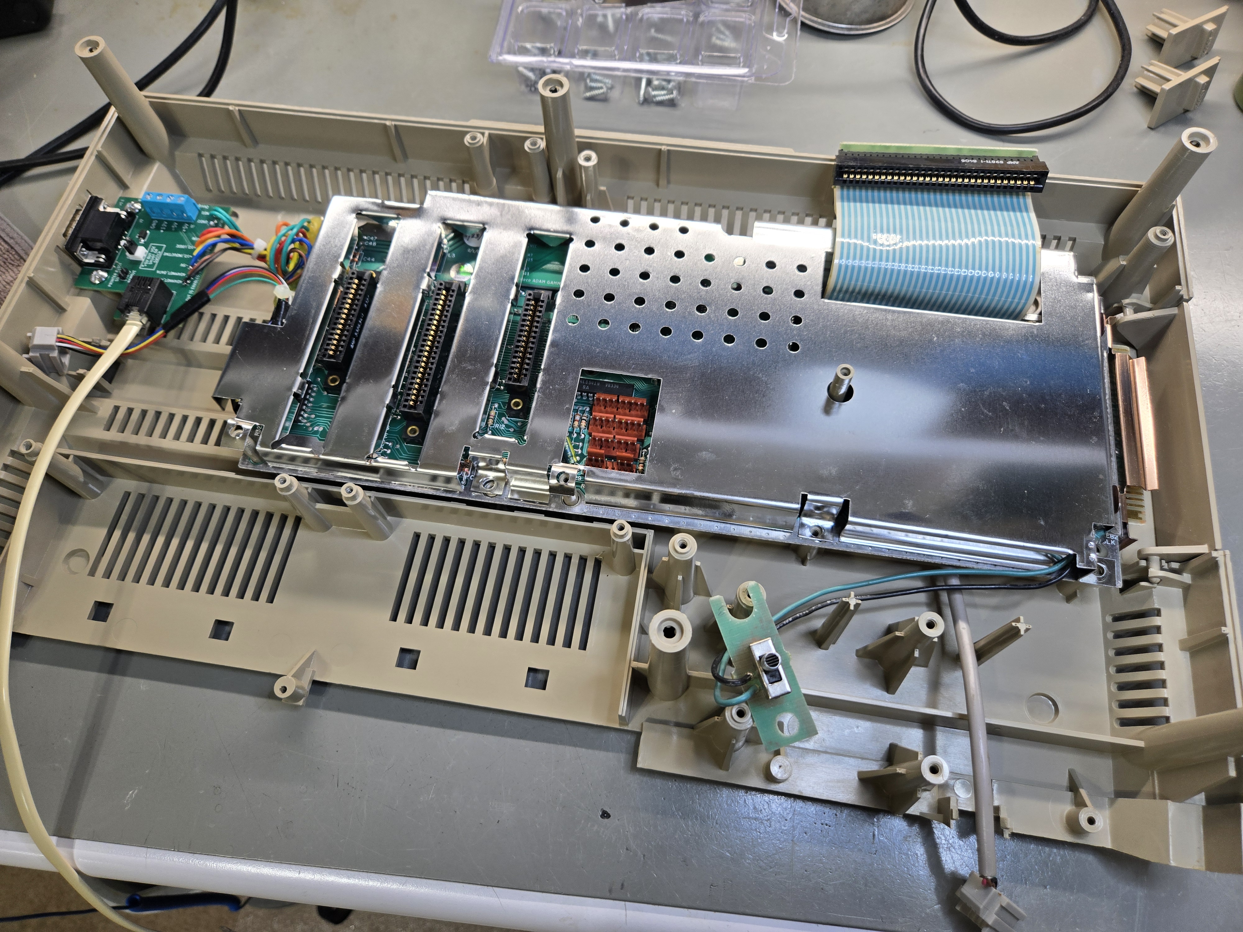

Case modifications/cuts

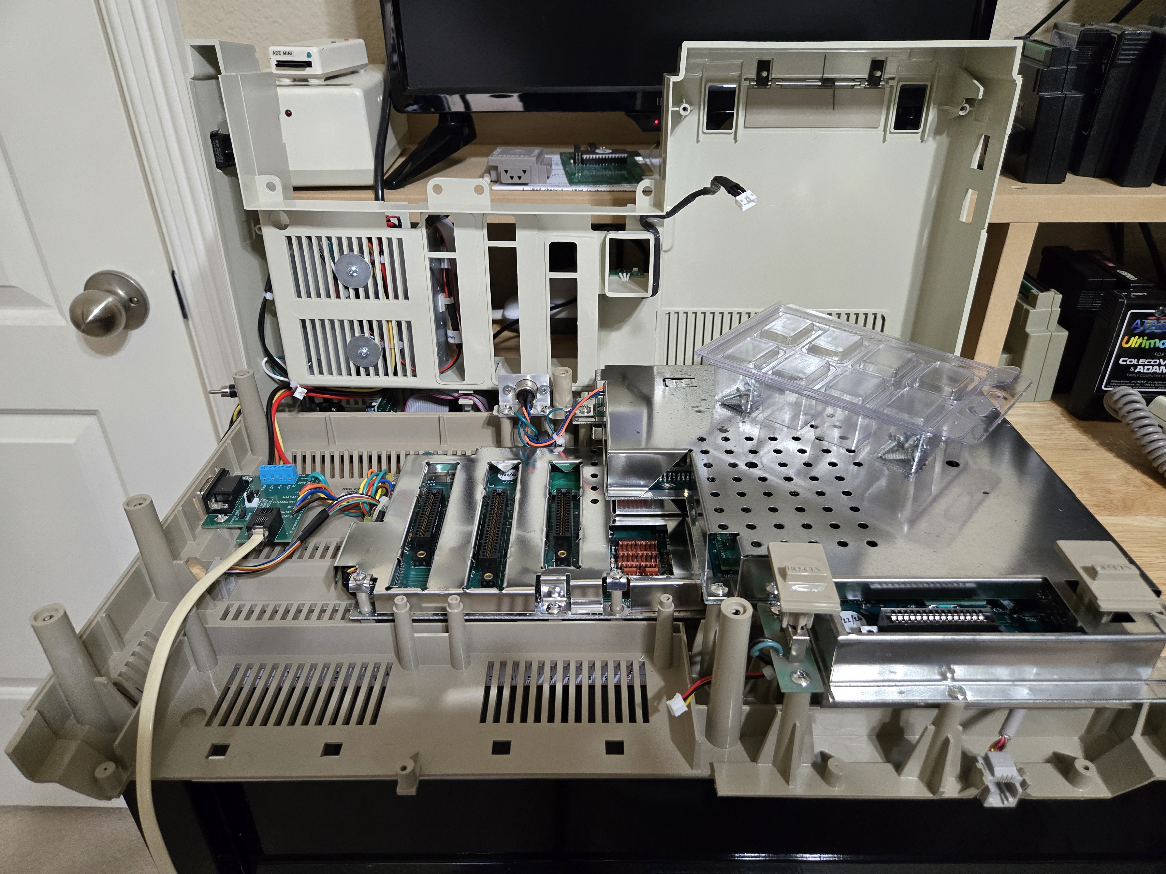

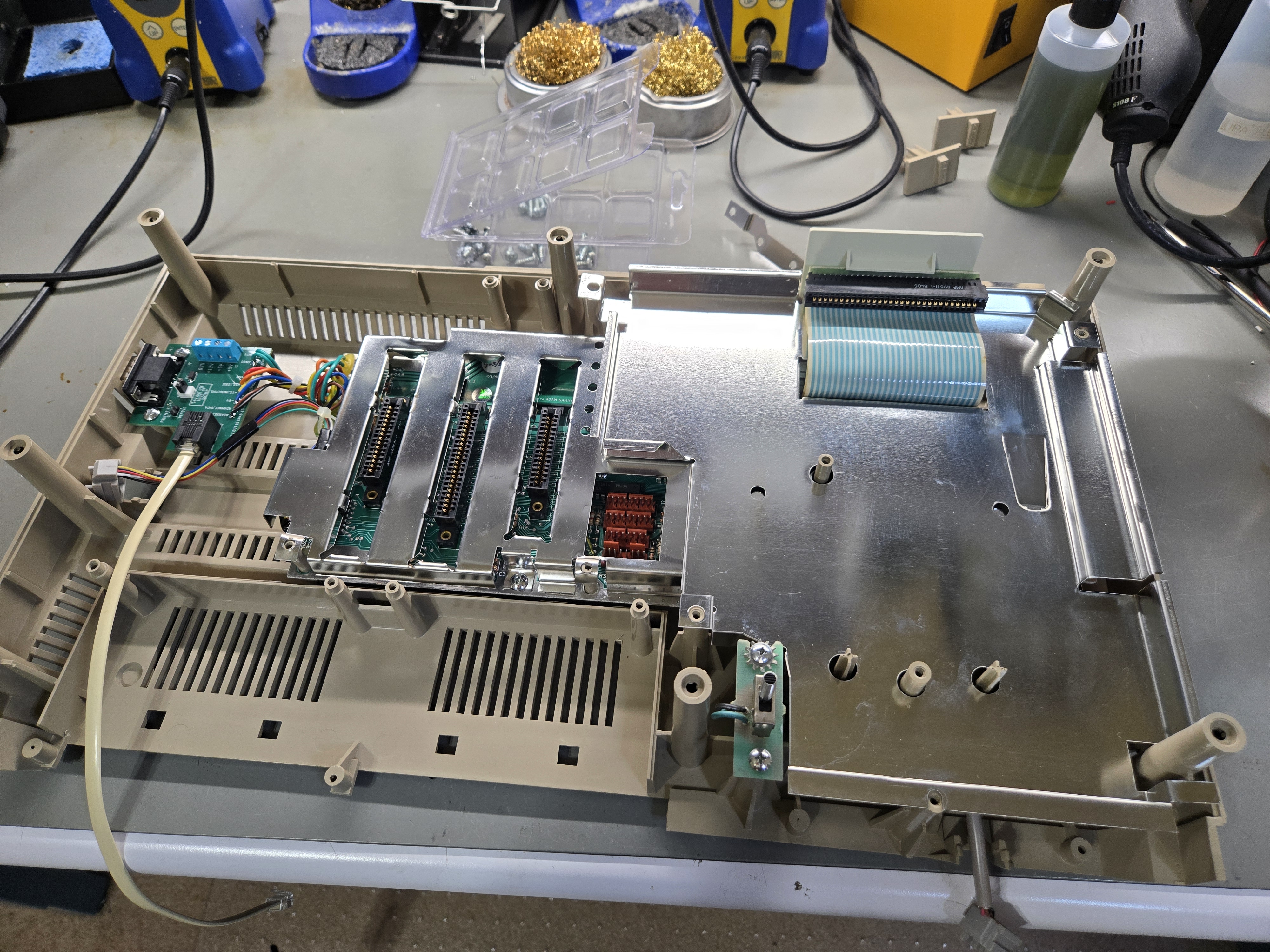

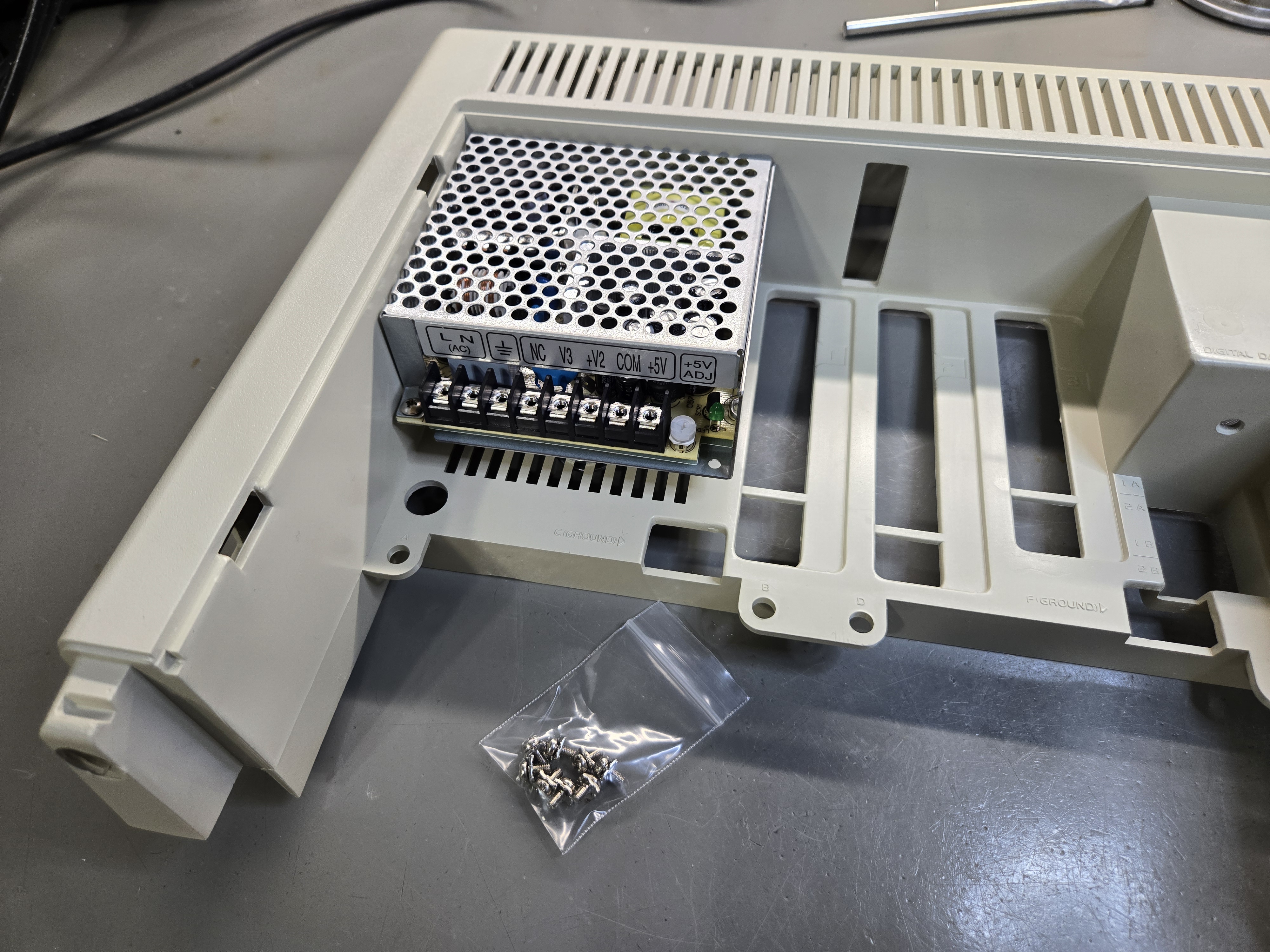

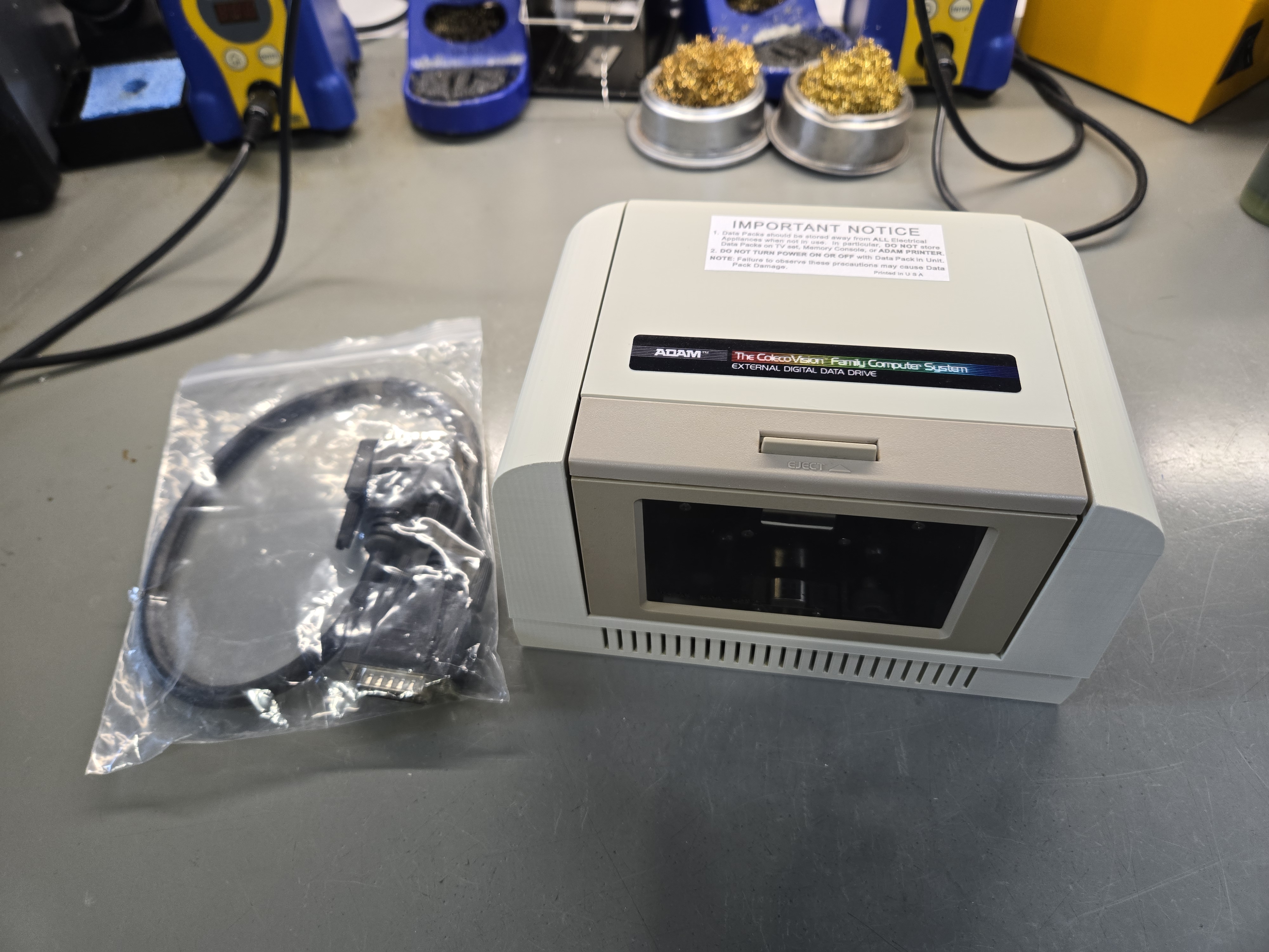

Post by Tekman »

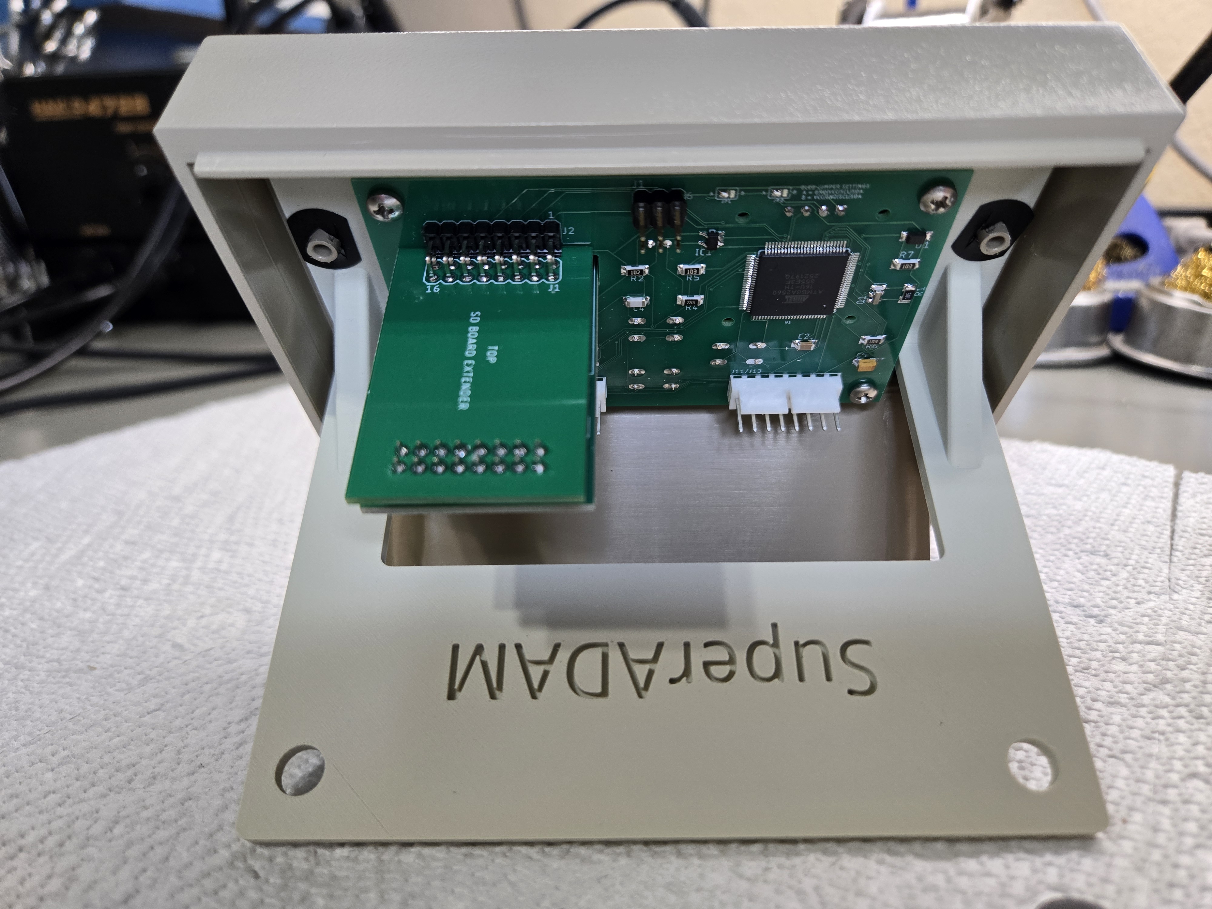

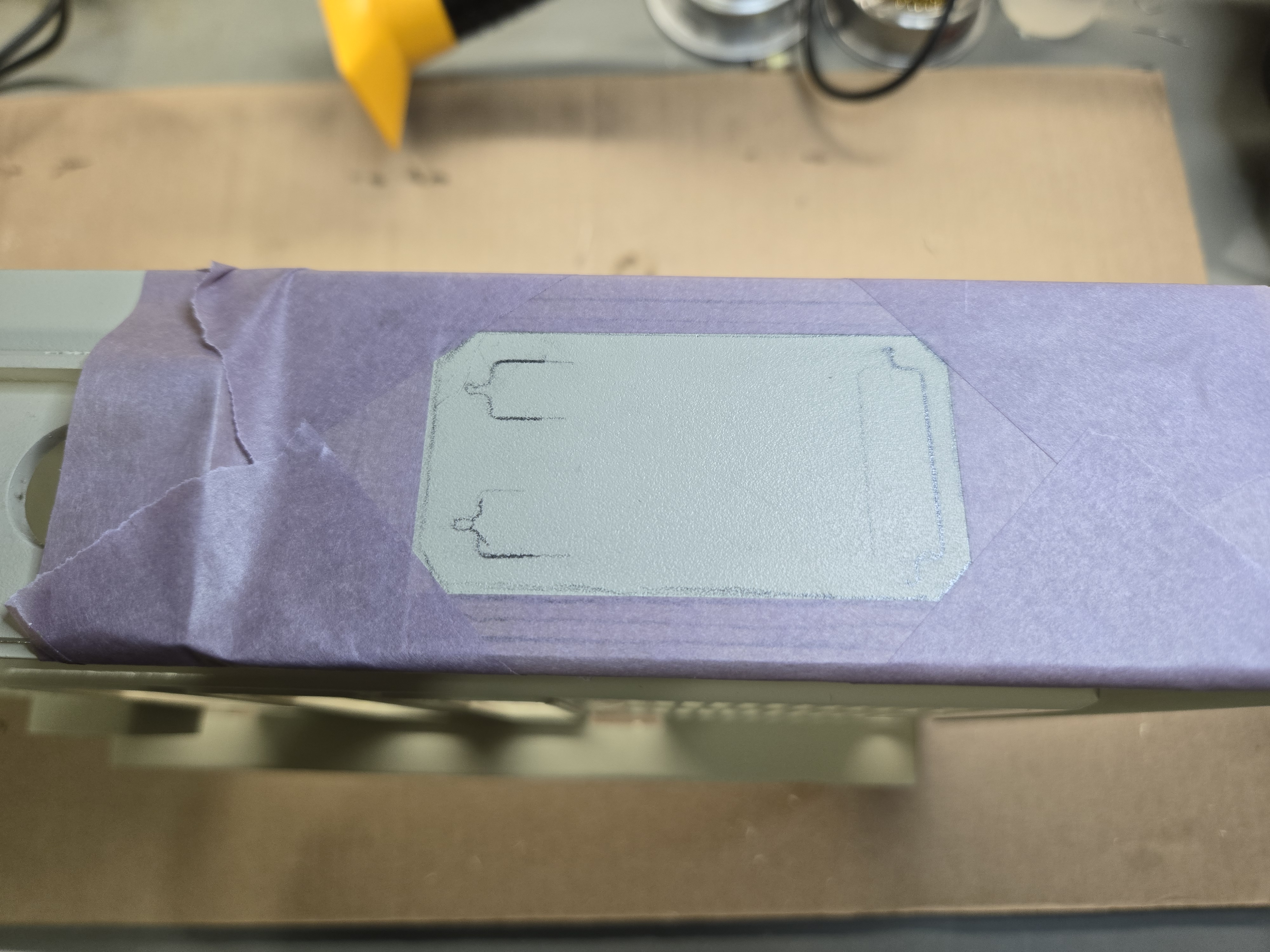

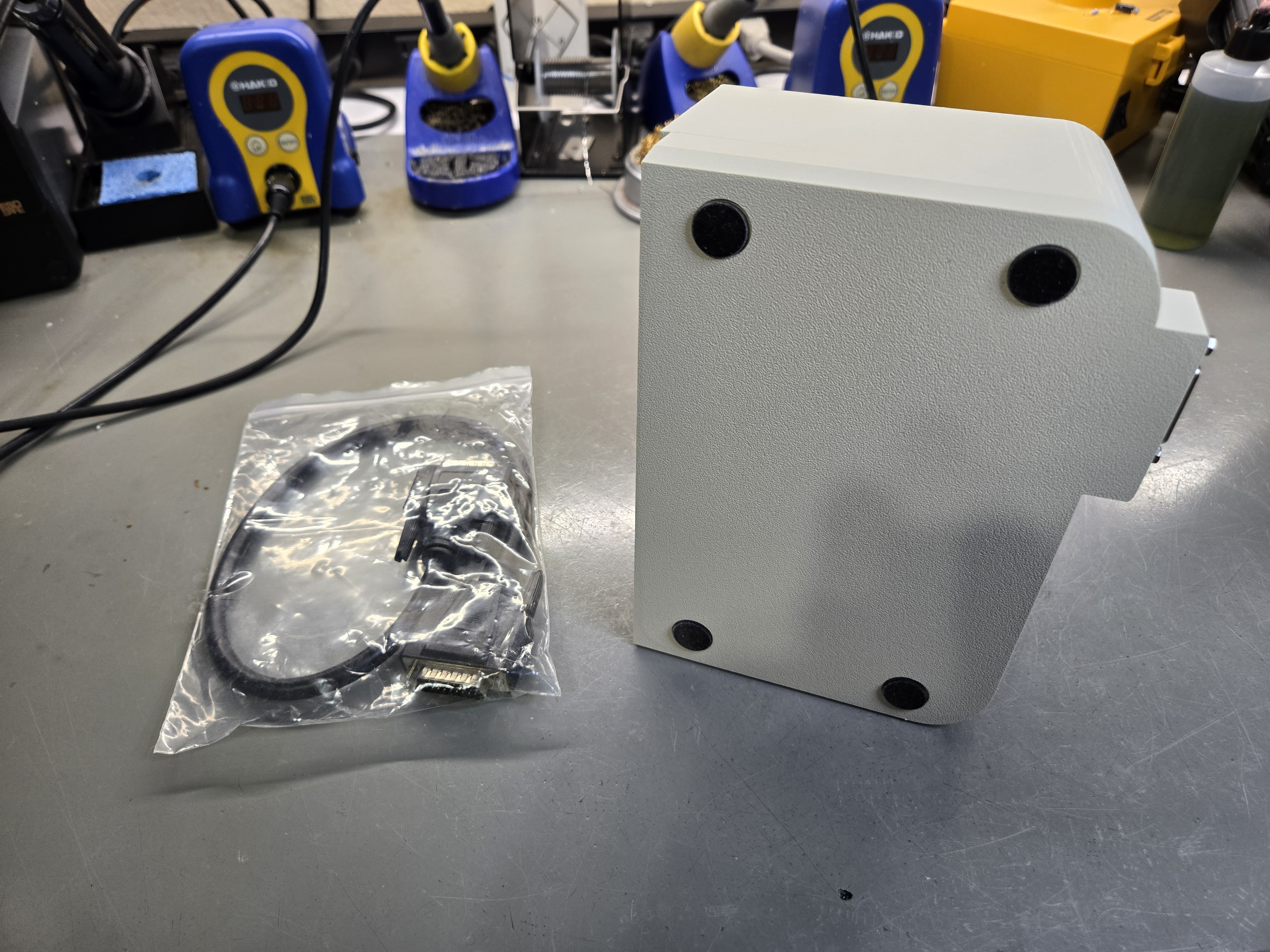

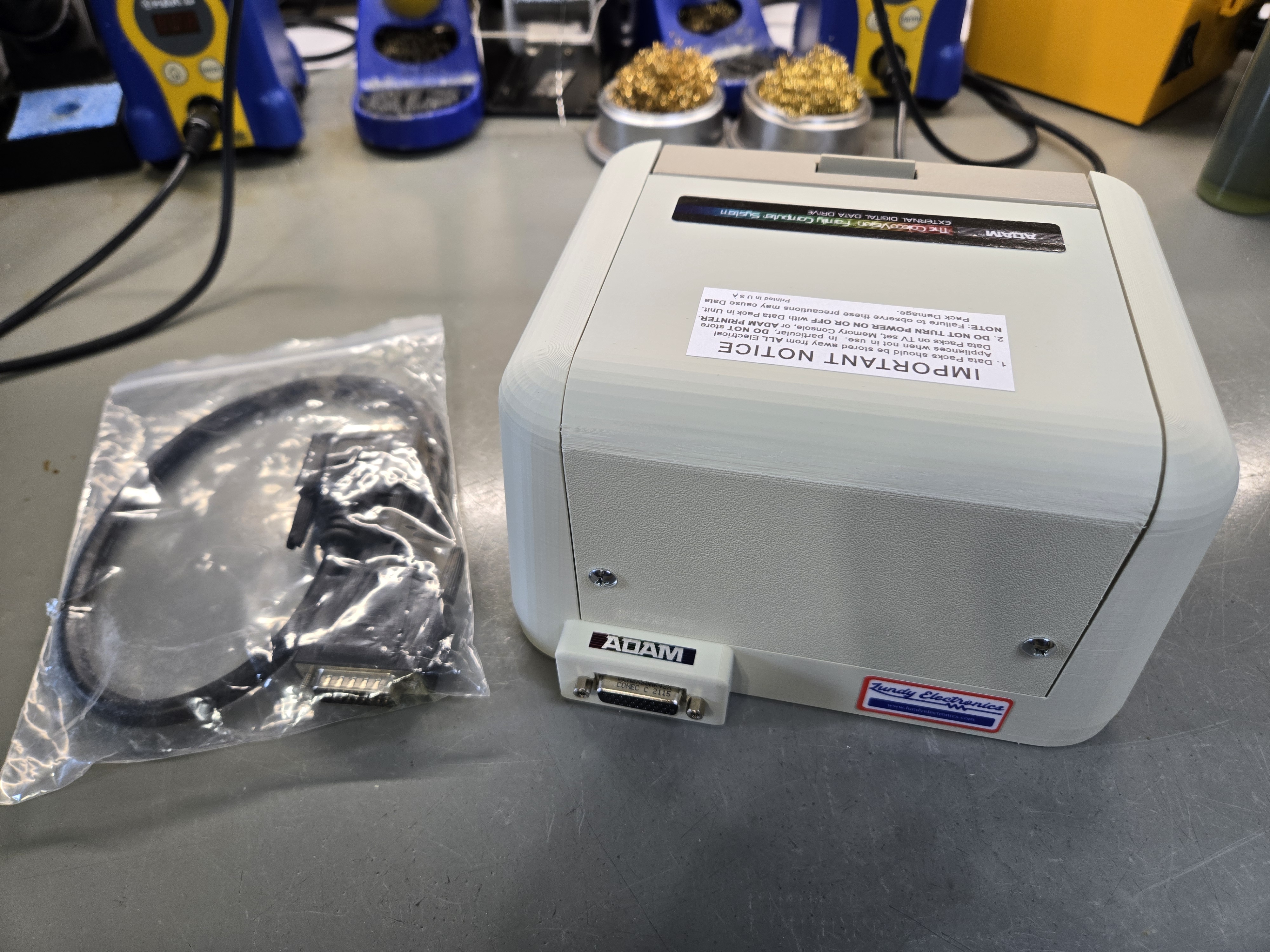

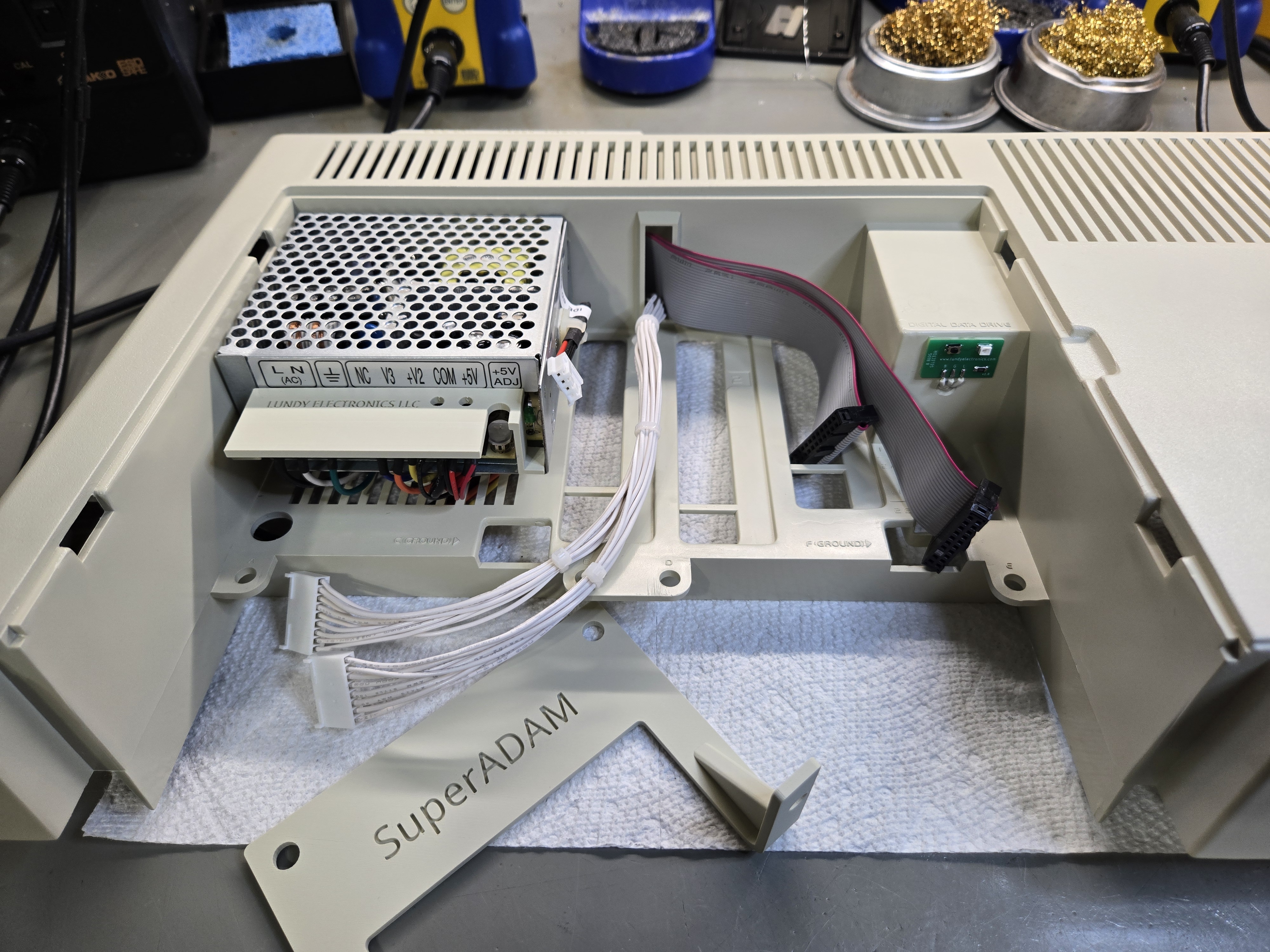

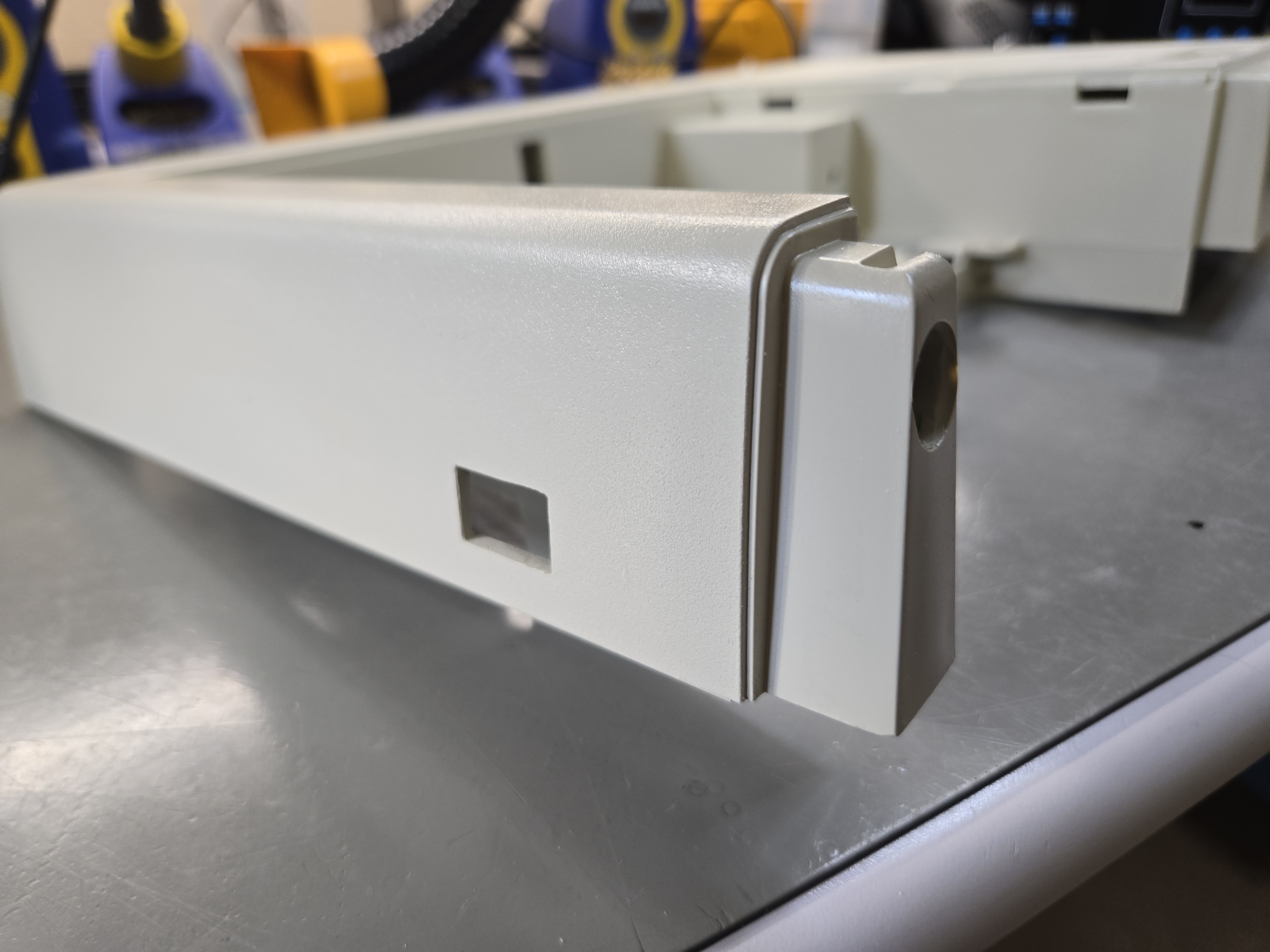

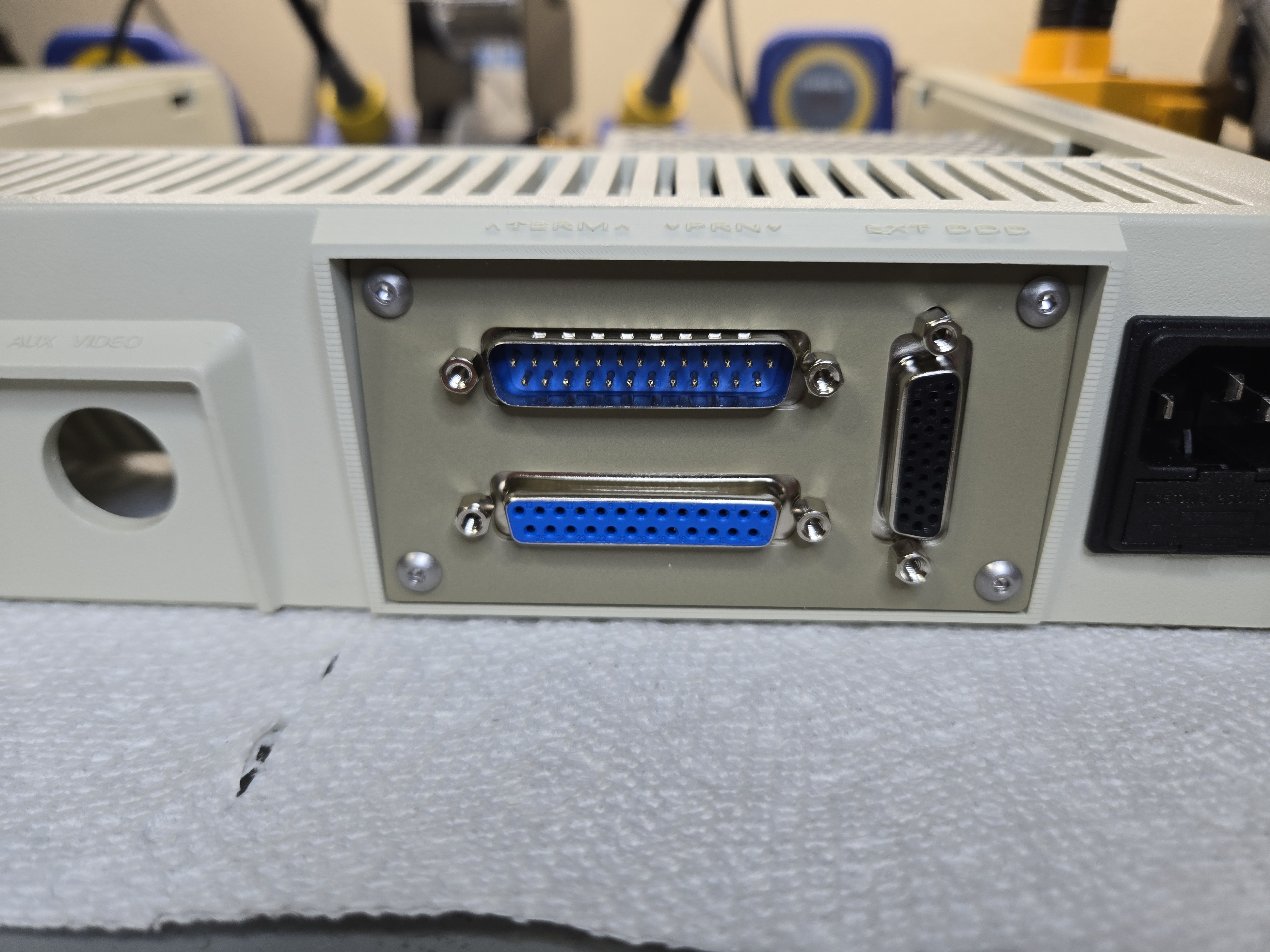

Building up the case and external DDD assembly

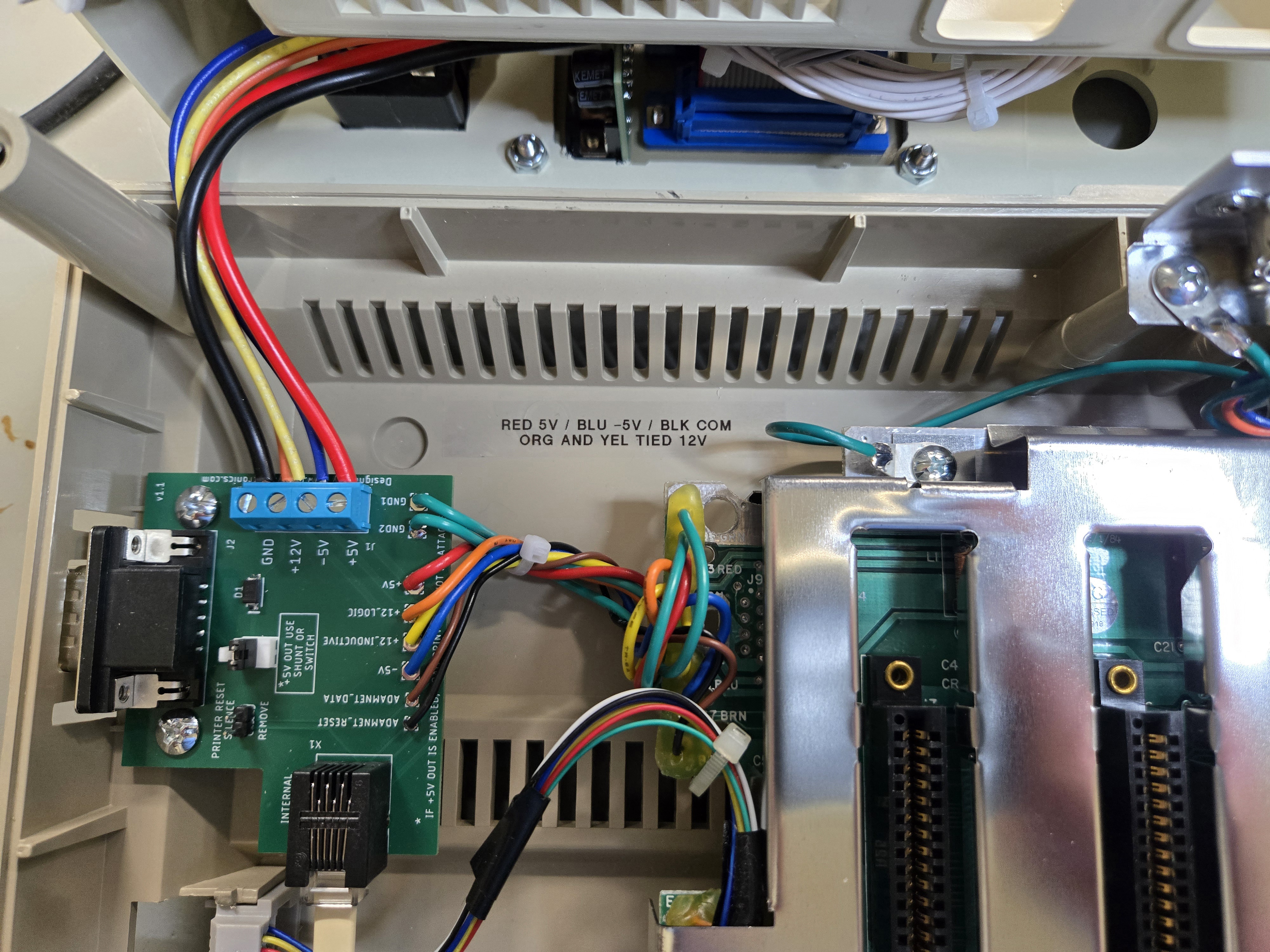

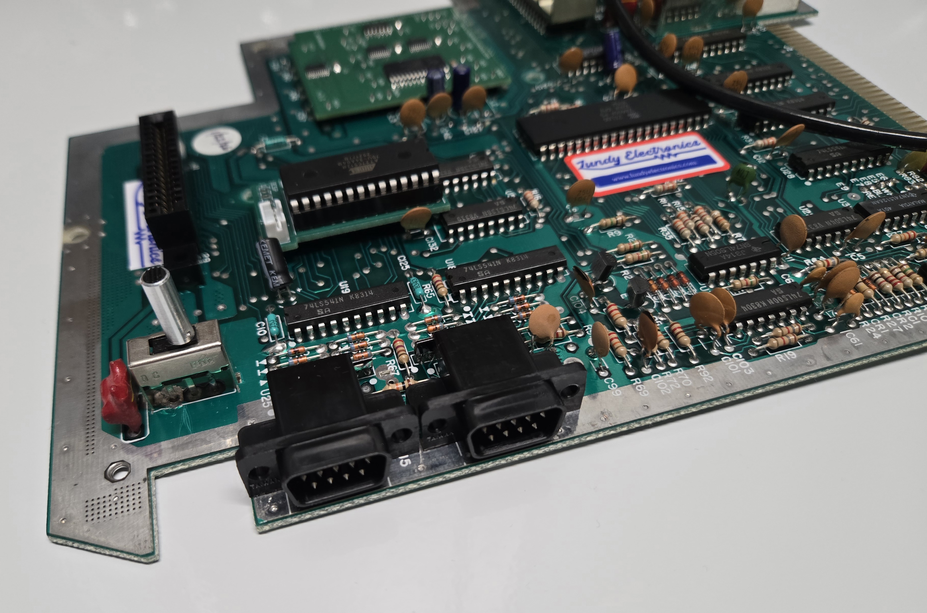

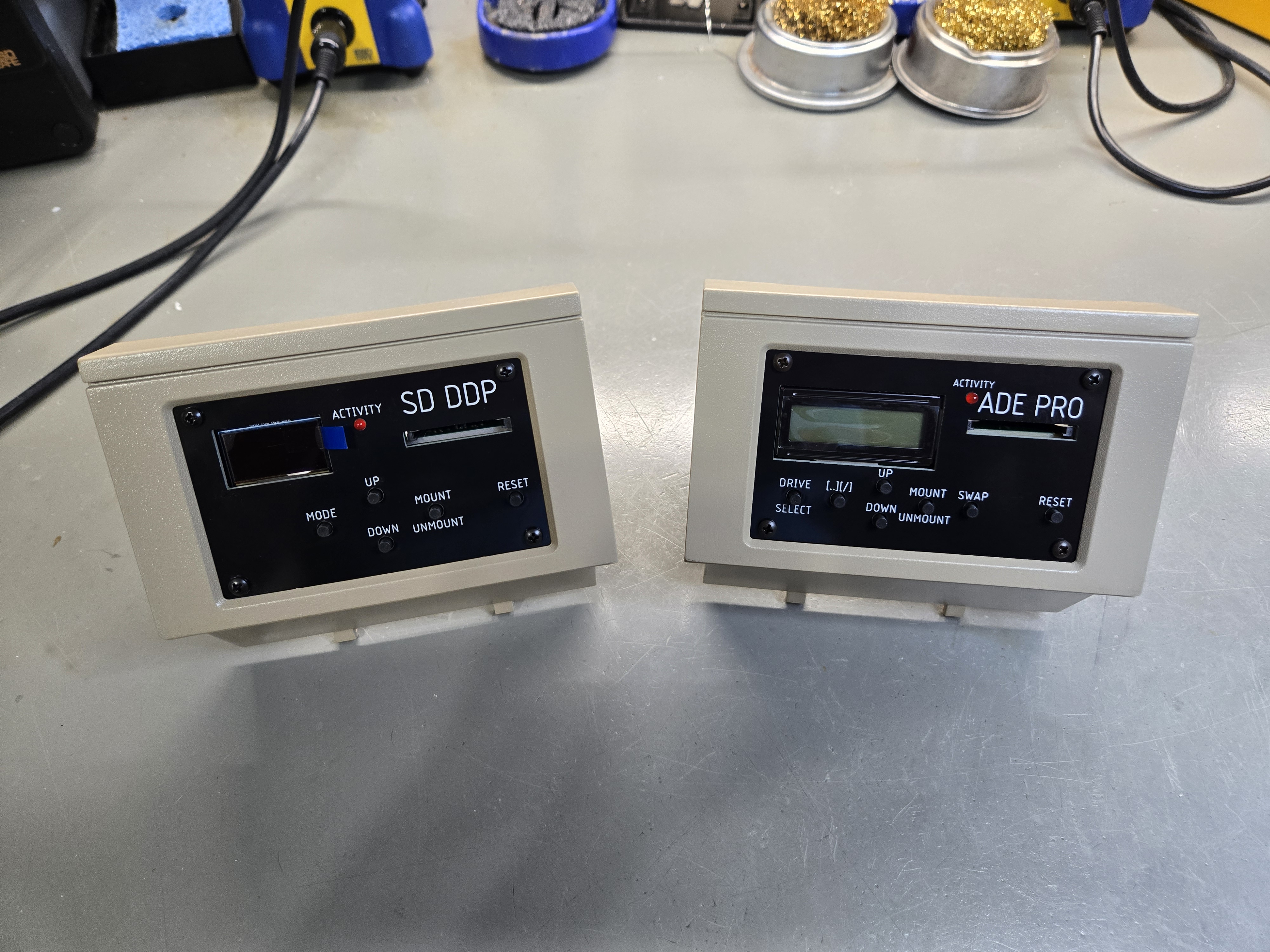

Post by Tekman »

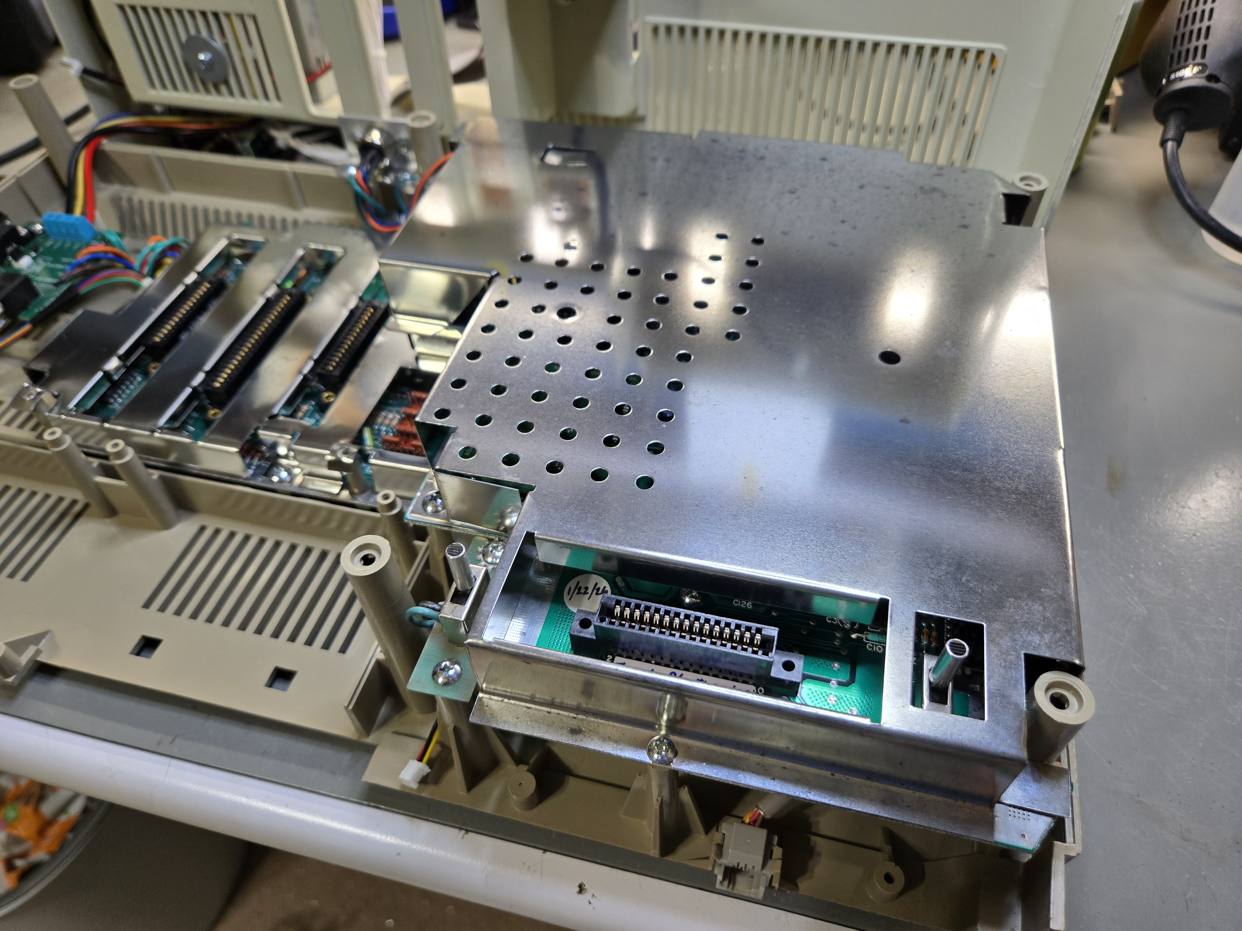

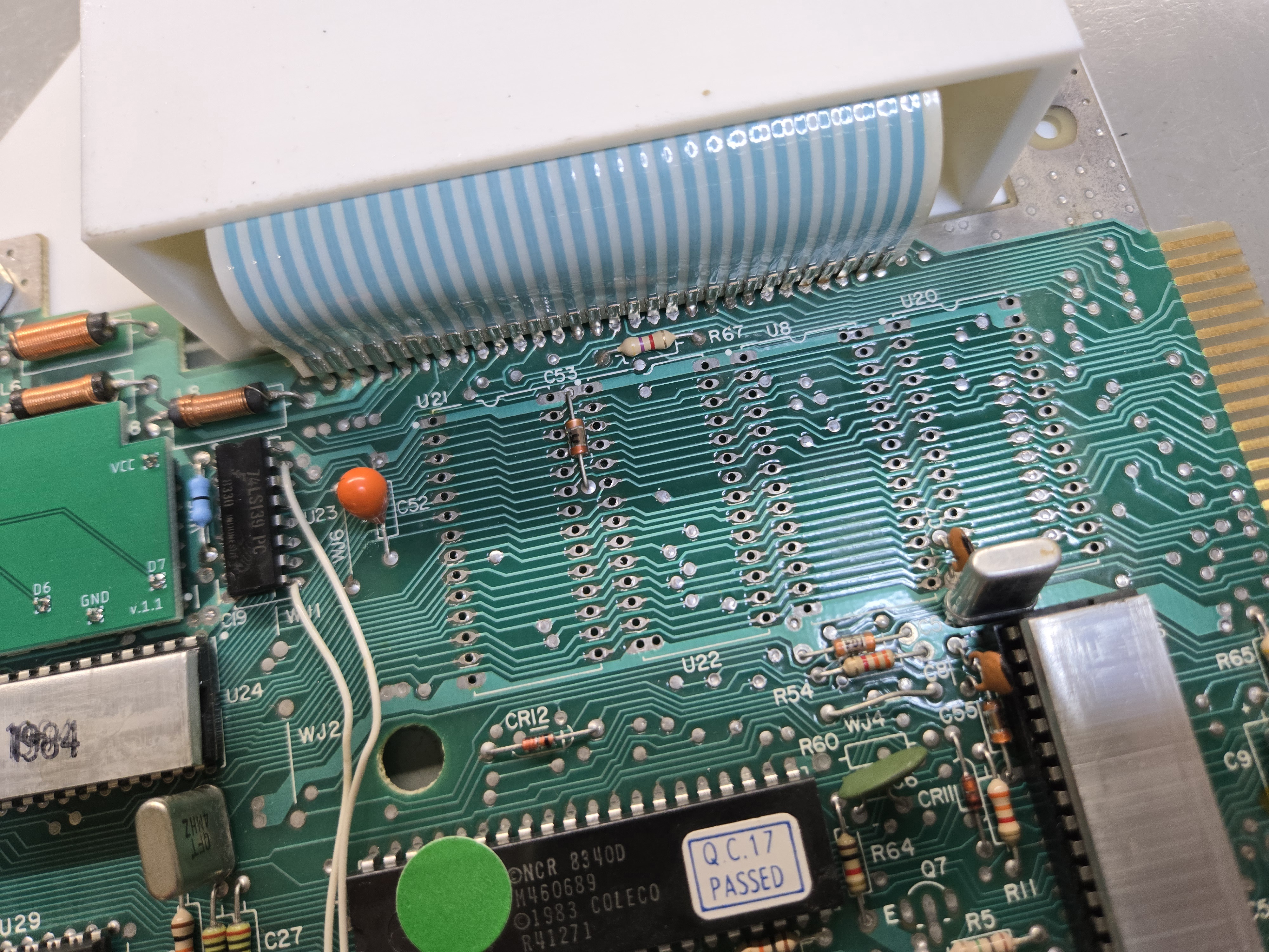

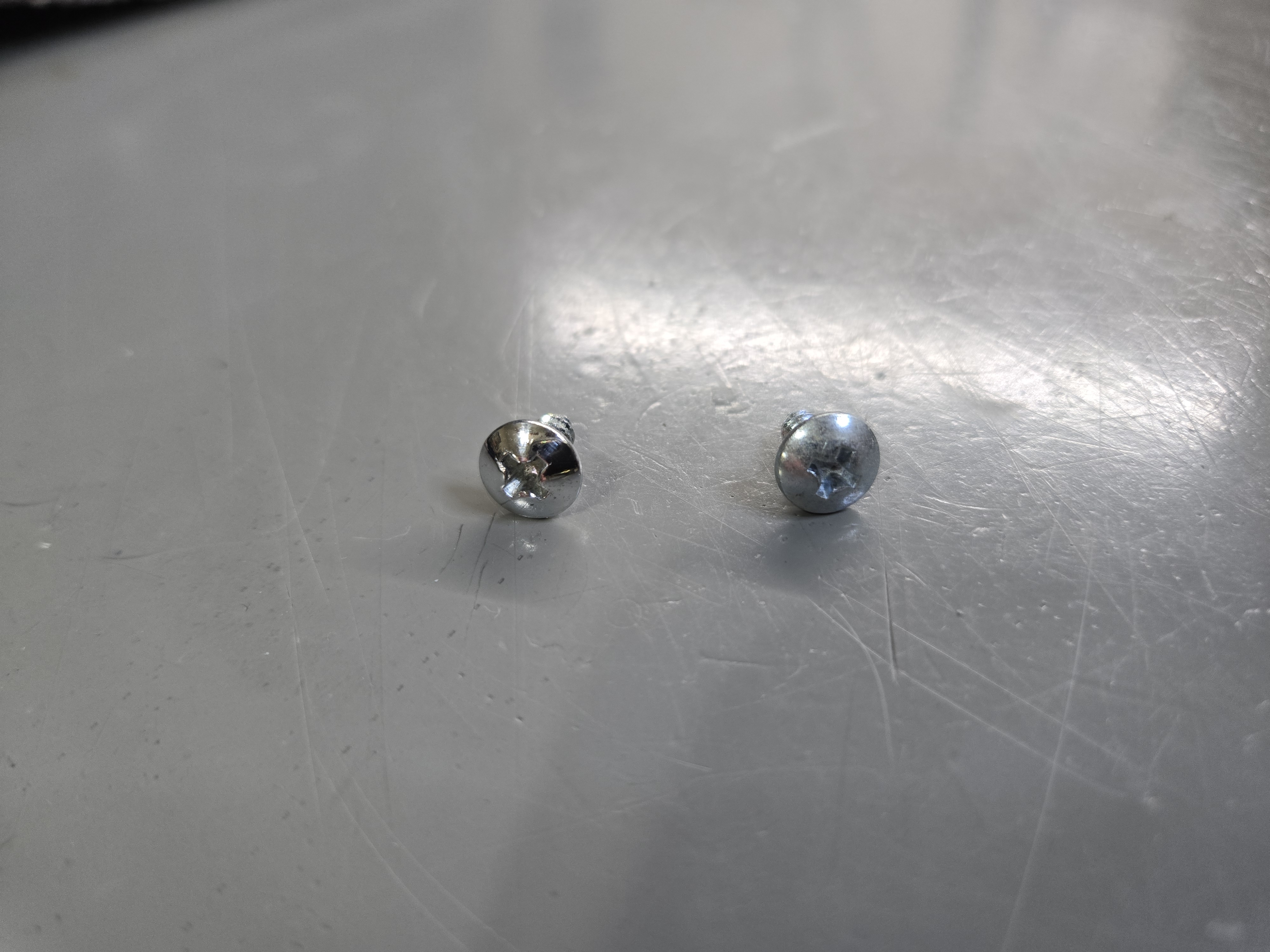

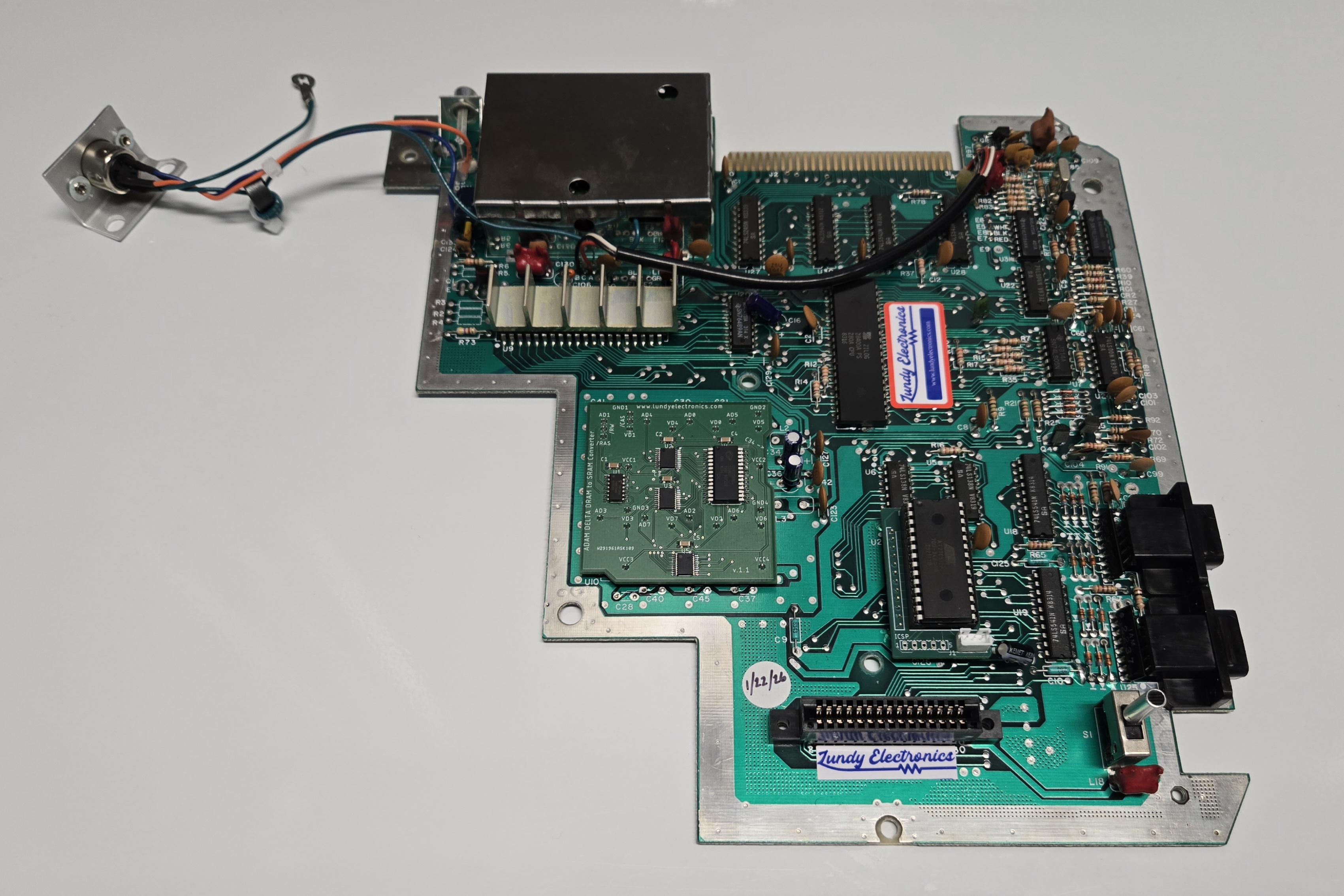

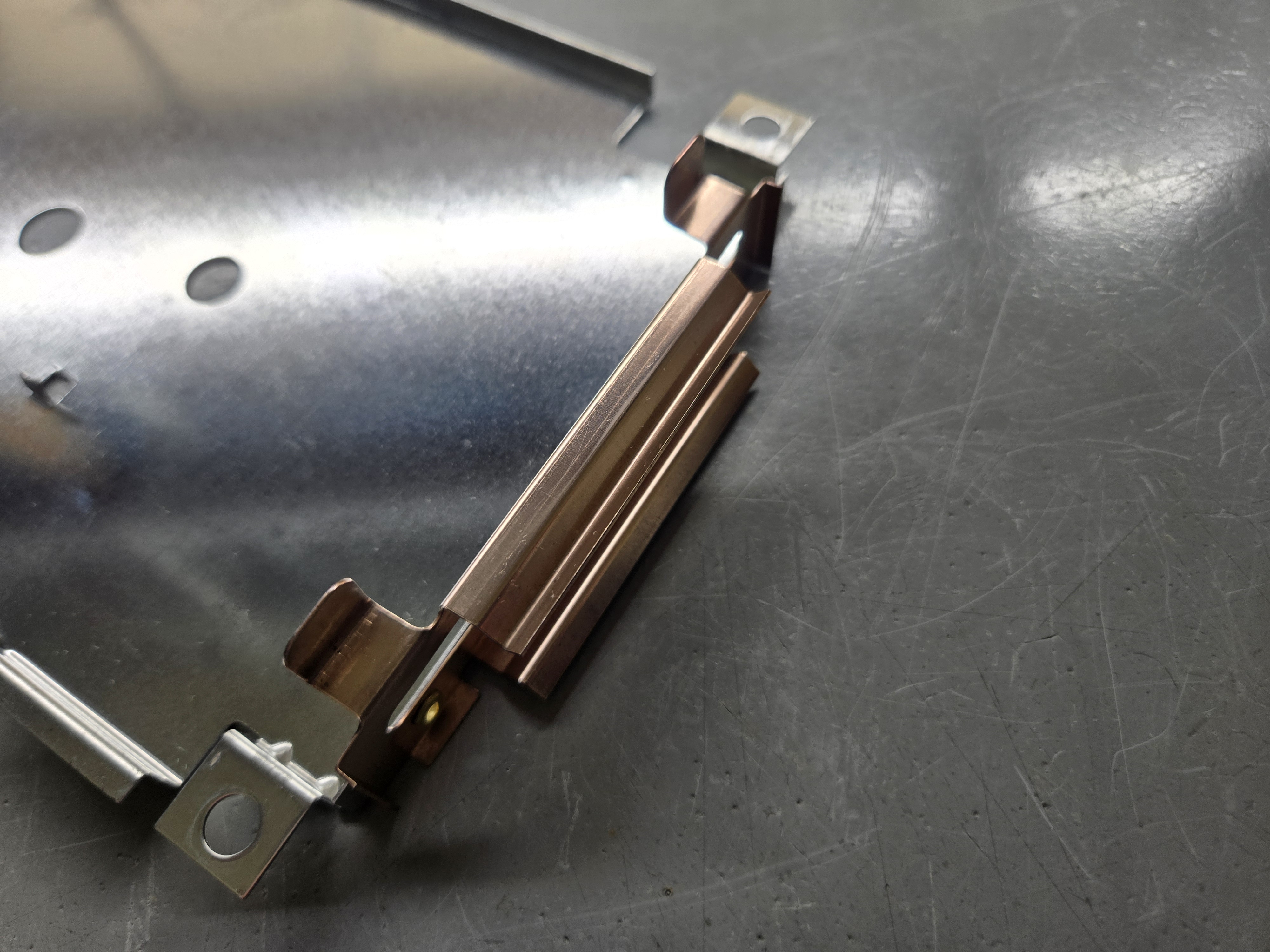

Installing boards. All hardware and metal RF tins get polished to a nice shine. This example already had some good looking RF tins and probably one of the best I've ever seen.

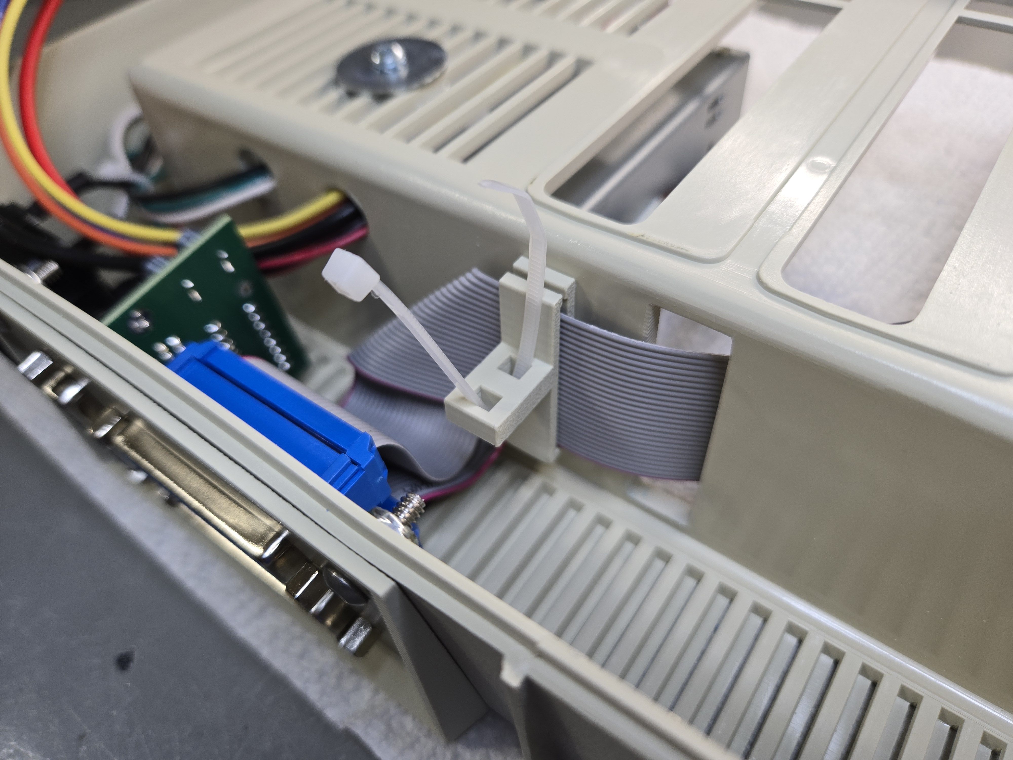

Post by Tekman »

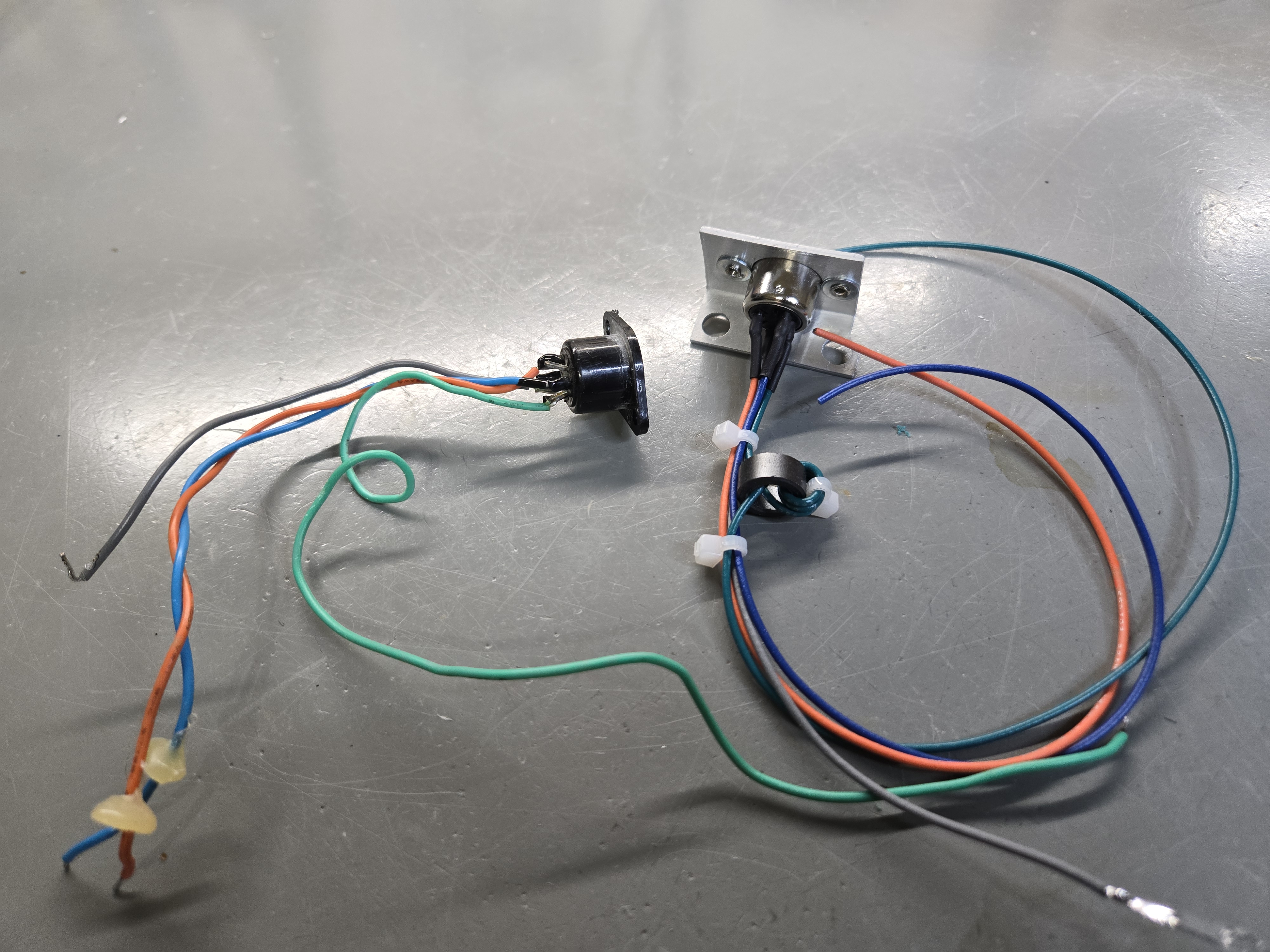

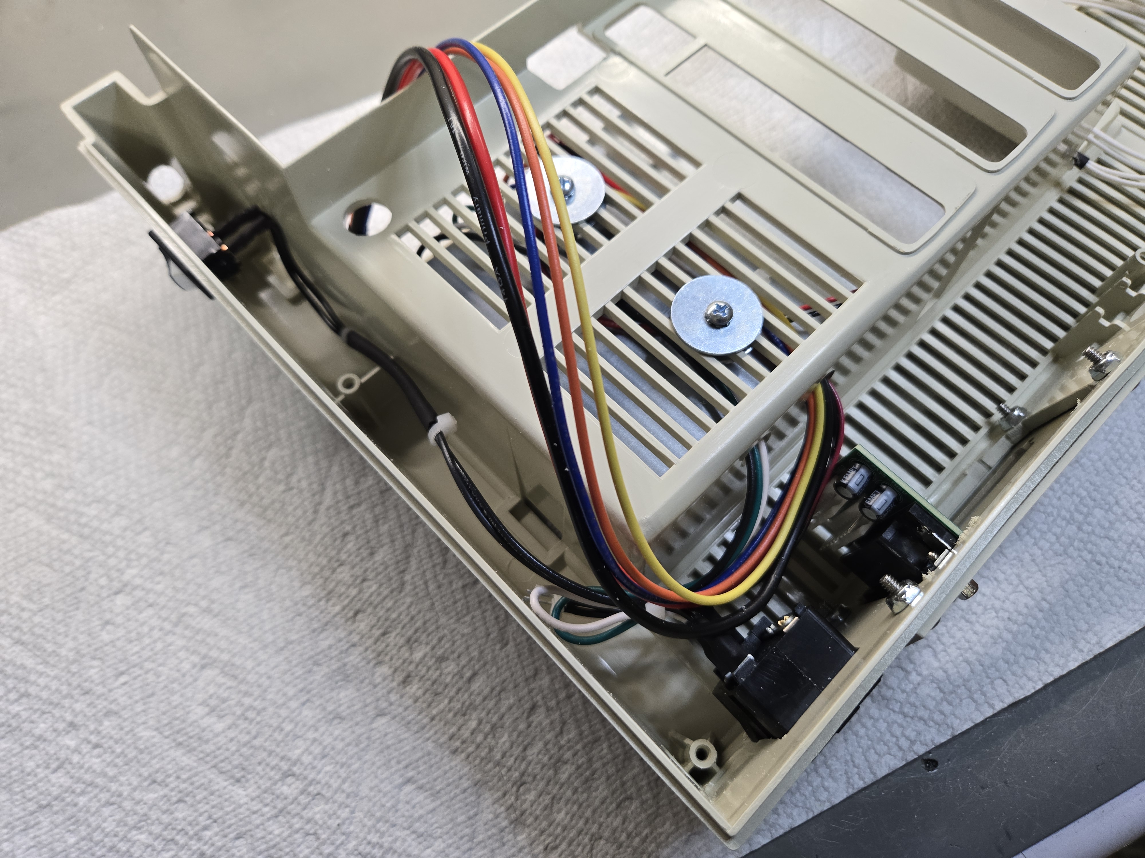

I wasn't happy with the final internal cable harness length for the external data drive and had to order more wire to make a little longer one. I'm in a holding pattern until then.

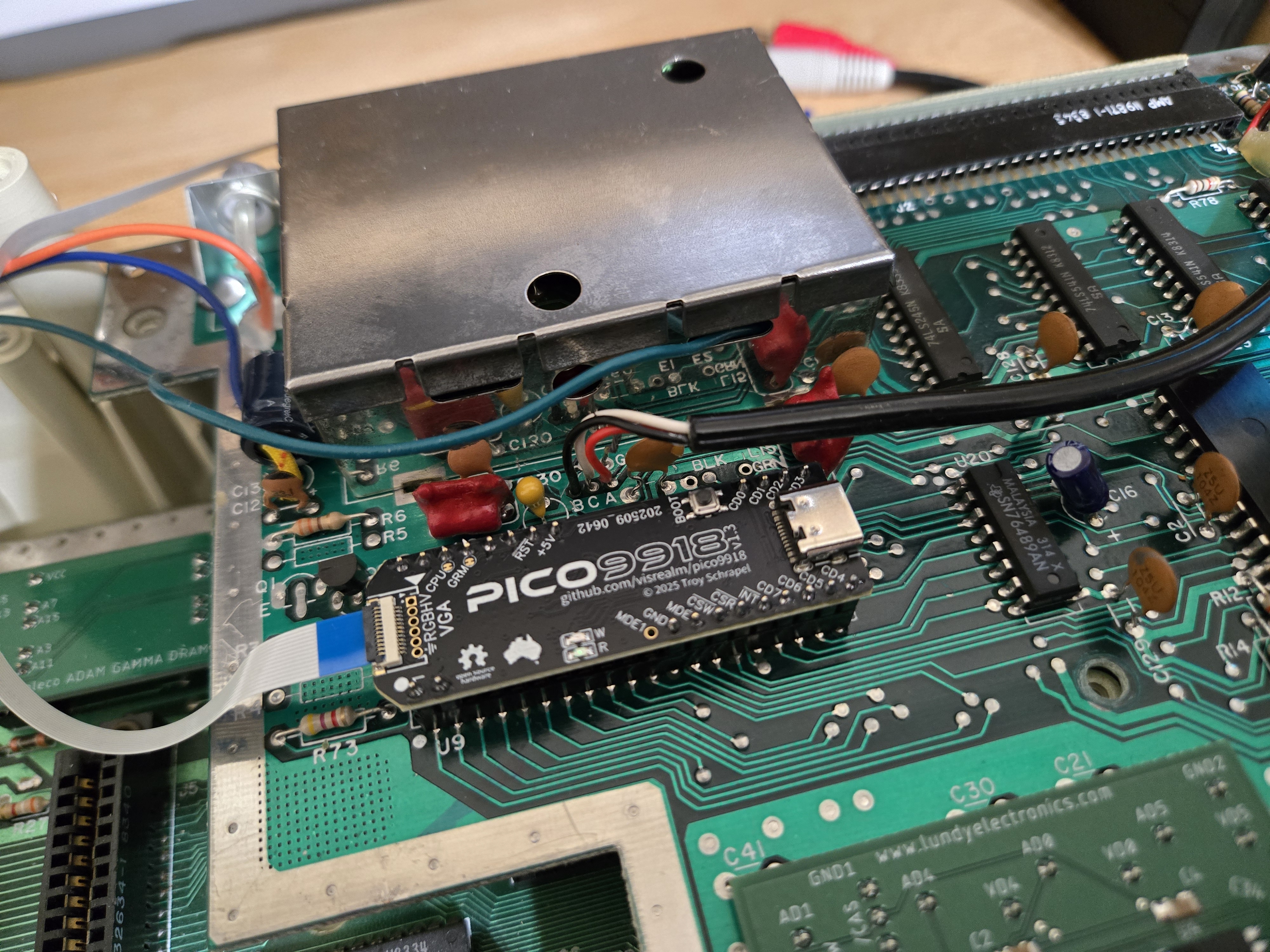

Post by Tekman »

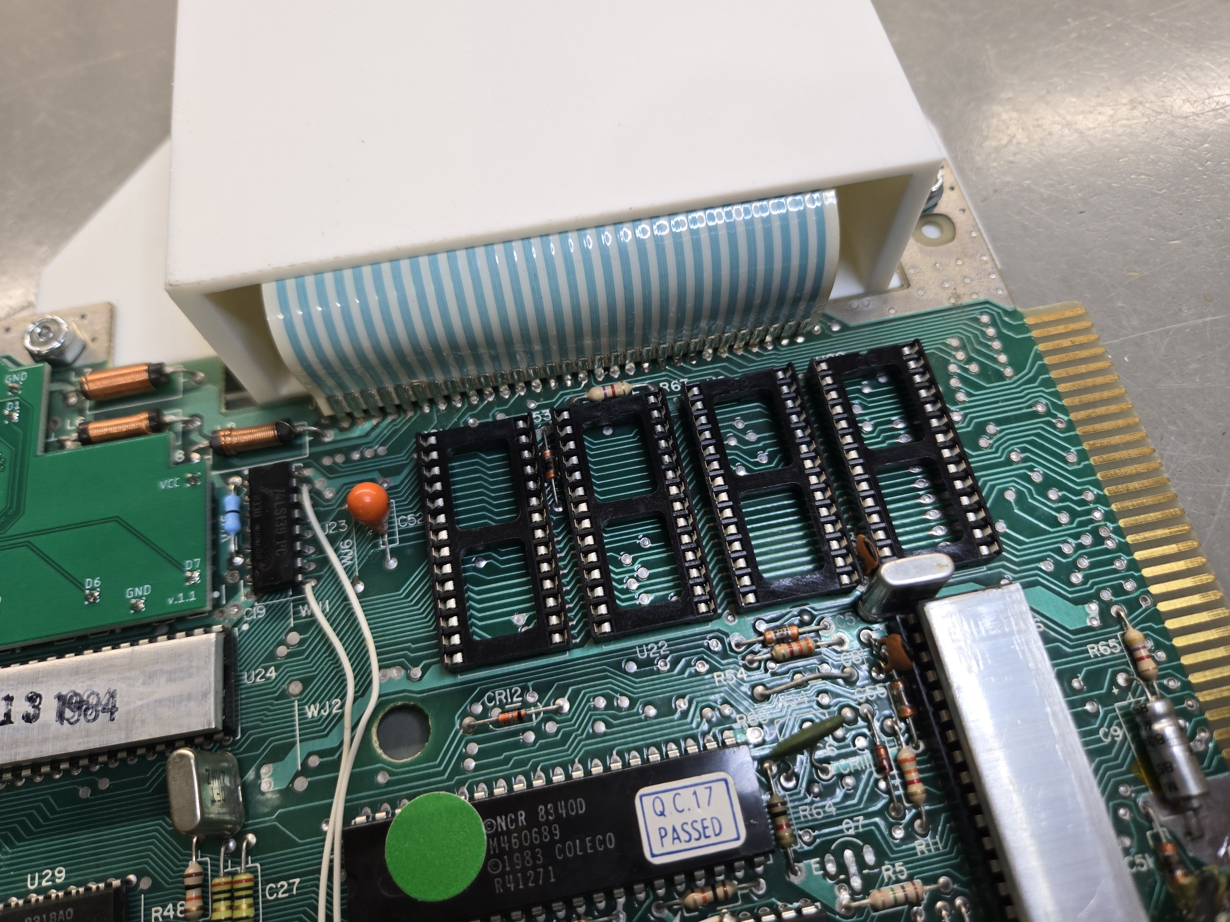

After getting sidetracked for a few days, the PICO9918 is now installed. The default VGA dongle looks great, but that will be swapped for HDMI once the new HDMI dongles get here.
